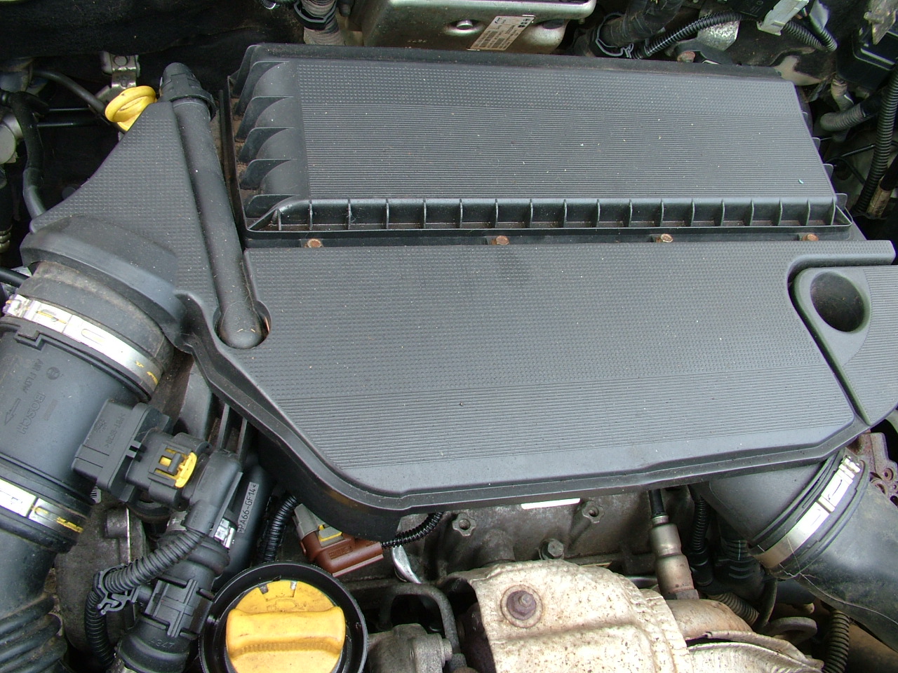

On your model you have to undo the plastic breather pipe by dipstick, the two large plastic pipes held by clips needing a special pair of pliers (you can do it without but more of a fiddle) nearest to the airbox, the breather pipe just below the MAF sensor then it should pull off to see the injectors.
Note if you release the MAF sensor by easing the yellow tab outwards a little then squeezing the clip to gain access, if you run the engine with it disconnected it will throw up an error code on dashboard.
This photo is from a 2014 Vauxhall Coblo1.3MJ which I am guessing is similar to your engine, the earlier 1.3 MJs were much easier to access.

I left hte car at my local garage , they found out one injector was leaking. they disassabled the injectors cleaned the screw thread on both side and replace the washers. problem solved. I think that it is a job that coluld be done at home with a little effort and the right tools. cost 200/250, mostly labour
