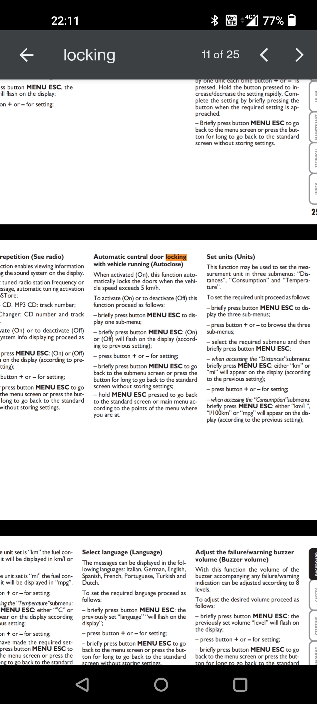

but also here are the instructions for disabling auto lock

If you want to disable it then go into the menu using the buttons bellow the drivers air vent. If you don't know how to do this then I suggest you read the owners handbook.
