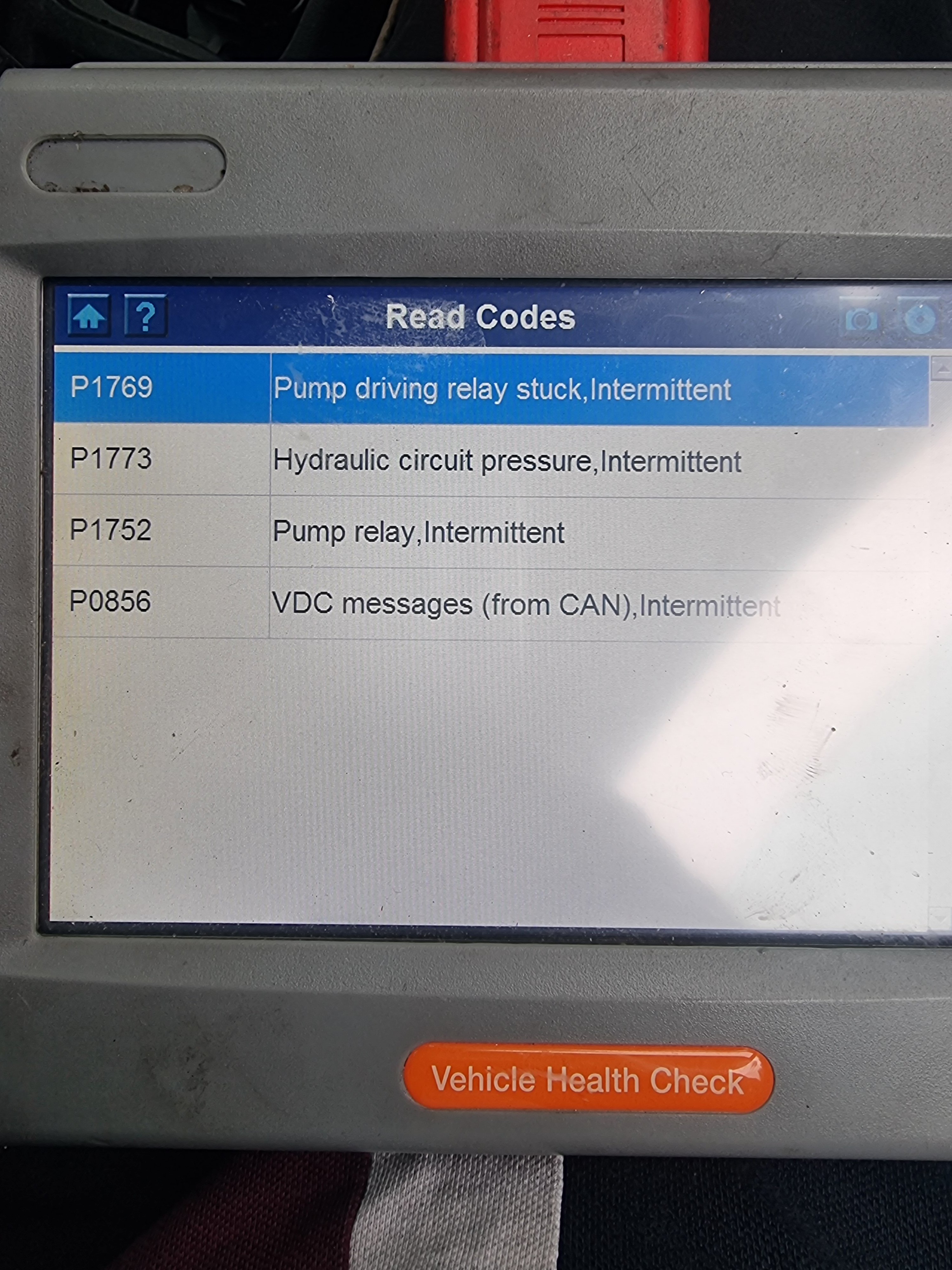

Hello, can somebody help with any ideas đź’ˇ, I have a Fiat punto 11reg 1.4 8v whit dualogic transmission and the revers gear won't engage, the rest of gears are engaging ok. I attached the picture with the failure code . Thanks in advance!
Dualogic gearbox issues are a massive headache. There can be a number of causes, the only recommendation is to get it seen to by a specialist who deals with these gearboxes and knows what they are doing. It could be a pump that needs replacing, fluid needs renewal or it can be much much more complex and you won’t know till someone who knows what they are doing starts to have a look
There's a long thread on Dualogic faults, that might provide some help. Most issues seem to be loss of hydraulic pressure due to age related seal failure.
