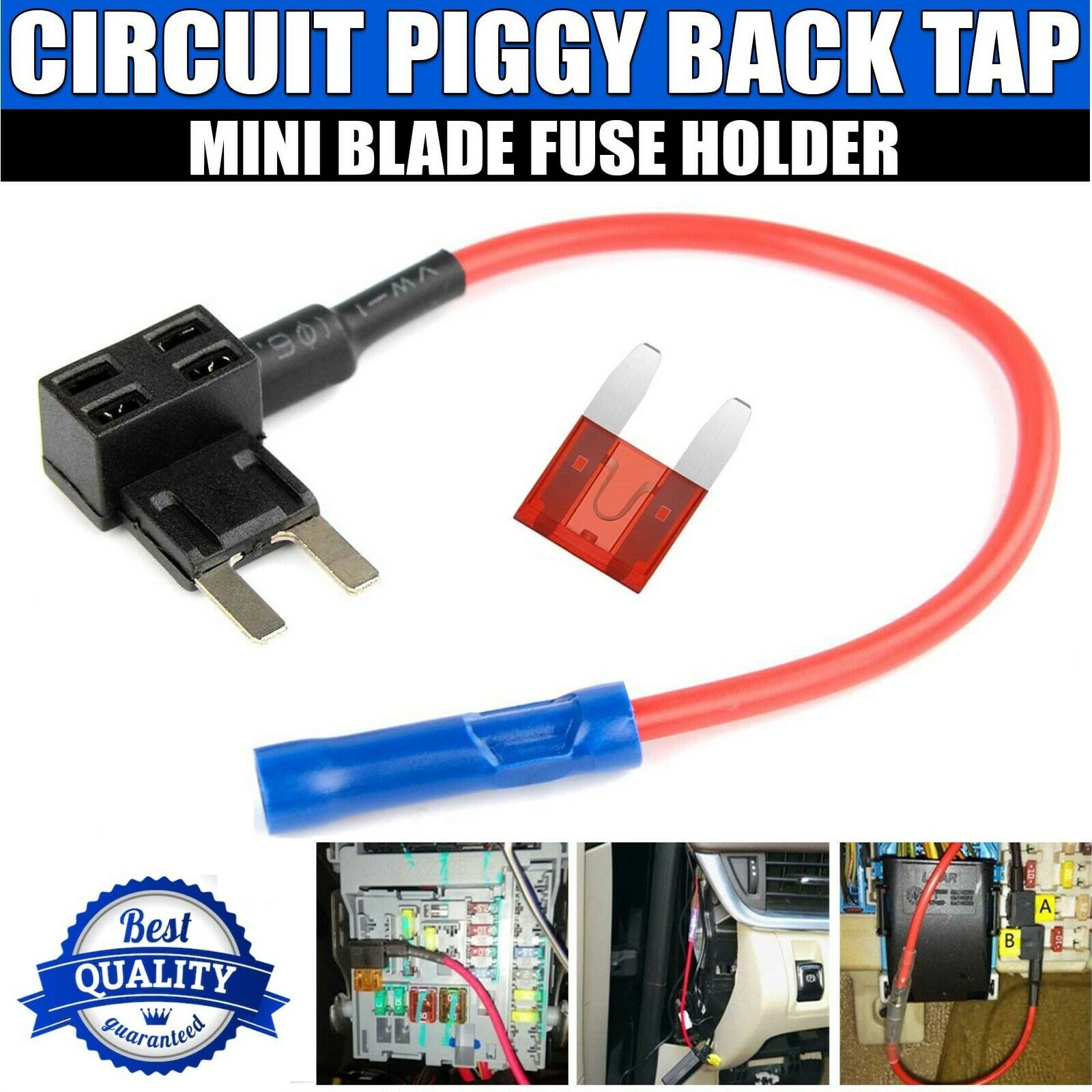

3. Now unfortunately, the MK2B Punto has as CANBUS system and does not use a dedicated +12 v wire to the stereo. This is something that aftermarket head units require. You will have to fashion one yourself somehow. There is a guide on the forums that instructs you to take a piggyback fuse and hook into the circuit that supplies +12 v to the cigarette lighter (this is always on when you turn start the car, and turns off when you remove the key - ideal).
4. So what you do is you get your piggy back fuse wire (see picture- they're like £2 on eBay). Remove the 20 amp (A) fuse for the cigarette lighter from the drivers side fuse box. Stick the piggyback connector in the hole. Put a 15 A fuse and a 2 A fuse in the piggy back connector
15 A + 2 A = 17 A (it's safe as there was originally a 20 A fuse there).
Crimp a bit of wire to the piggy back connector (the blue crimp will accept a wire). That bit of wire needs connecting to the new head unit. You can feed it from the fuse box, under the steering wheel (our of sight) and up behind the centre console and connect it to the bit of the plastic connector of the FIAT wiring loom that will ultimately connect to your new head unit.
5. Connect the wiring connector with your new +12 v wire to your new headunit. Place your plastic fascia that you've bought into the hole left by the original stereo. Wiggle in your new head unit. Done.
Sound confusing but it's pretty doable. Once you understand what you're doing and have the parts in front of you it's pretty easy to see what goes where.
Also bare in mind that I cannot guarantee this will fix your KISS radio receiving issue. This might sound dumb but is the aerial fully up? You can change the angle of the aerial on the roof of the car from more flat (180°) to kind of pointing upwards (90°).
