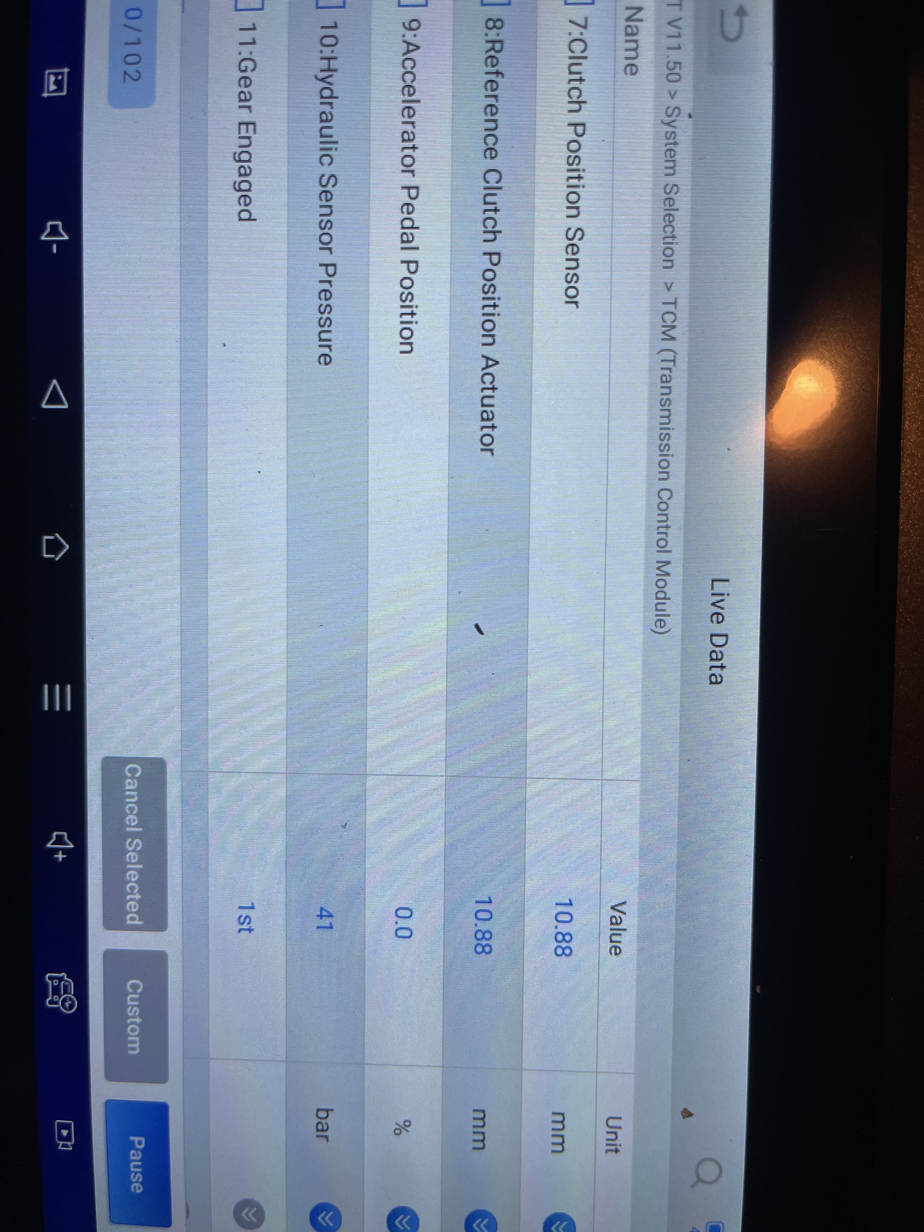

Is my clutch worn out
I have screenshot from one scanner related to clutch .
Plz advise .

Either clutch plate slipping or clutch not fully depressed.
I need ur guyz opinion .

BUT the gearbox wont be much diffetent to a conventional 5 speed Manual
( yes the Diesel probably revs lower)
With a Manual you can obviously lift off the throttle at a steady 100k/ 62mph and revs and speed will SLOWLY fall..
Really the dualogic should do that too..
If the revs tumble..but speed doesnt ..
then a clutch issue is possible

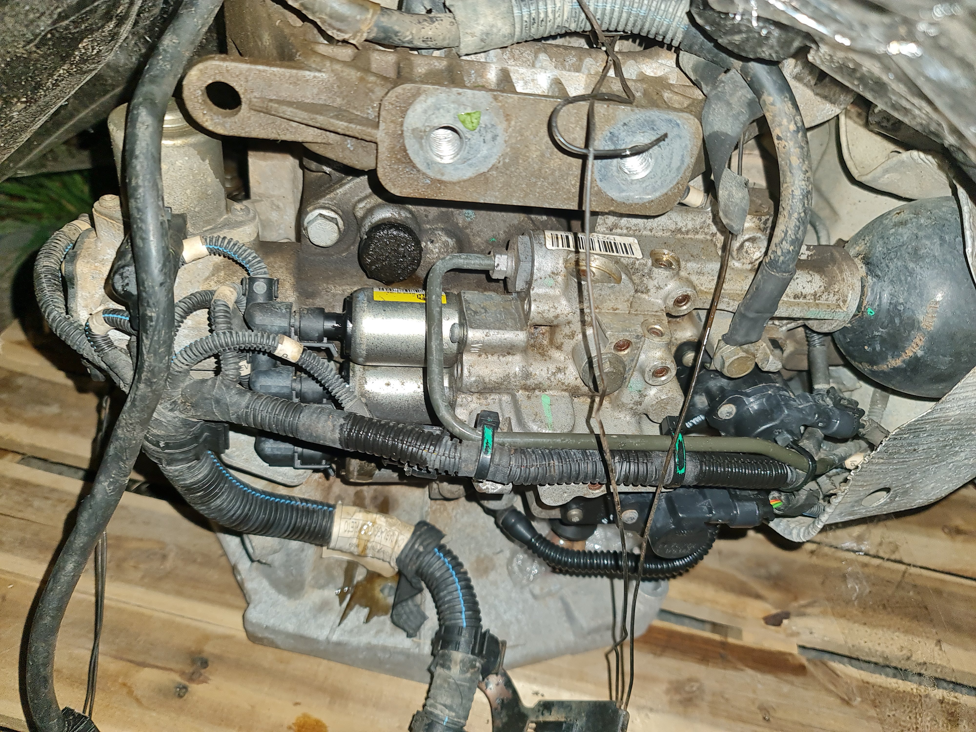

Hey guyz got a used low klm dualogic gearbox from wreckers for 750 aud with 2 months warranty .
