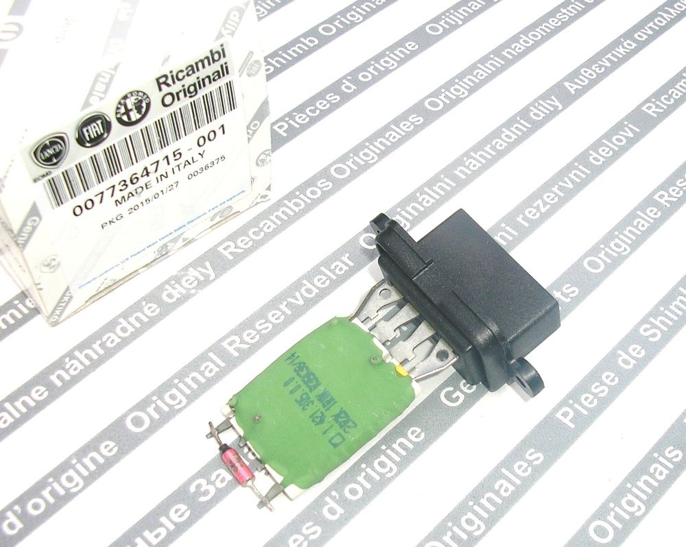

heater only working on number 4 only ?
hello there old buddy
2008 punto, is that evo, grande?
if interior fan only works on speed 4 then your problem is in the fan speed resistor which looks like this
attachment.php
Thanks Flisko ! got it sorted buy one
but found it difficuilt to put put back in couldn't get it to clip in just used plactic tights
