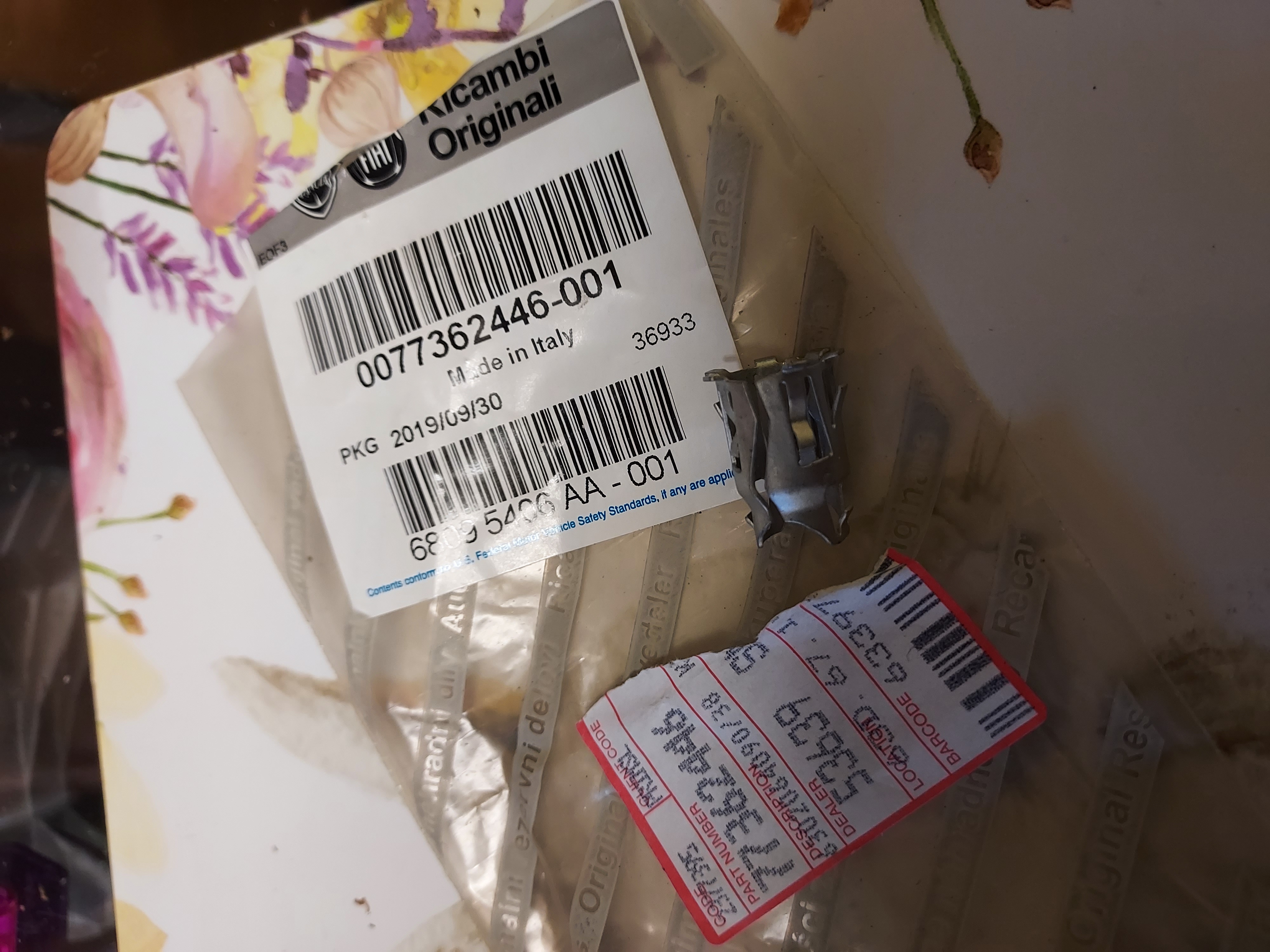

Thanks for your help, I finally managed to get two, however I thought it was part of a complete set of springs etc, for the brakes shoes, and all it was, was the two little handbrake cables securing clips, at the price, of £24 .95 , main dealer only...who got a few choice word's from myself, I was expecting around a pound each at the most..... so be warned folks, they are not cheap ?*

They look identical to the ford ones which are available individually but they are pricy too.
