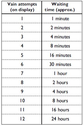

The radio says "BLOCKED/WAIT" because someone has tried a wrong code too many times. You need to leave the radio and ignition switched on continuously until the "BLOCKED/WAIT" message clears, then enter the correct code.
Depending on how many times a wrong code has been tried, the waiting time could be up to 24 hours.
