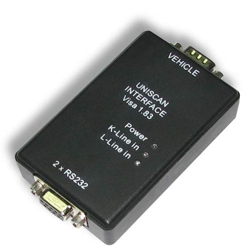

Well I found another program which people on the Alfa145 boards use.
It's called Uniscan 1.83 and needs a DOS based machine with a serial port.
Took a screenshot and looks like it has all the FIAT models including the sporting and the GT ones!
I'm going to order one for 50$ in aliexpress. I hope it works.

Uniscan will work on every pre-2000 fiat model but would need very old set up.
http://translate.google.com/transla...=visa+euroscan&start=20&sa=N&biw=1152&bih=620
Evidence of people who could connect to the 1.6MPI.
Problem is, you'd need an old machine or laptop that has 2X serial ports.
Program works only in DOS and needs a 40-50£ box.
There's a long thread here about the program:
http://www.obd-codes.com/forums/viewtopic.php?f=10&t=1583
Seems to be to much of troble to get such of old hardware but I hope it's worth it if I could set up something like that.

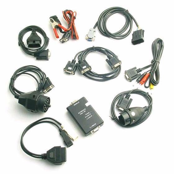

I have the Uniscan 1.83 software working on my PC but it seems from reading the other threads you need a specific uniscan unit and its cables as seen here;
If you find any information suggestion you don't need the uniscan interface please let me know.
