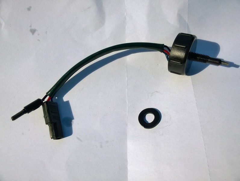

Hi,
I need to replace this fuel sensor or at least just the washer. I have been advised that I should replace the whole unit as it is the only way to get the right washer.
I have gone through the 'net' and have yet to find anything like ... any advice on direction or source please :idea:
Regards,
Nigel

O ring of appropriate diameter would probably be sufficient. Has to be nitrile, viton, fluorosilicon for fuel.
Pluming supplies should have all kinds of nitrile washers for boilers.

Finding an actual sensor seems a lost cause at the mo! The sensor is fine, so will follow that route on Monday.
Many Thanks :)
