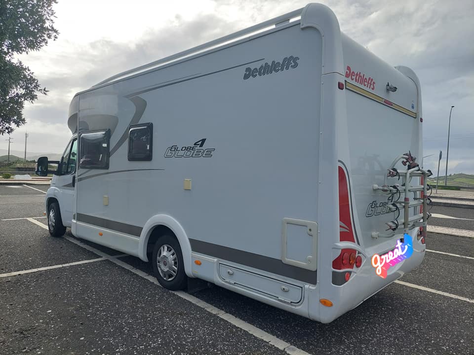

Hello there, I am about to buy a Dethleffs Globe 4 motorhome - Fiat Ducato 2011 (150 HP), with I believe an AL-KO chassis. Its very low to the ground, what you might call a "glamper"! Its about 4" lower than my current motorhome so I am wondering about the best way to raise the suspension.
I figure that air bags under the back springs may lift and stop the long overhang from scraping so easily in driveways. Maybe on the front too, but I have no idea whether this will destabilise the van on corners or high wind. So looking for various options of how to go about doing this, thanks in advance.
That looks about right for an alko chassis vehicle they do tend to be low down at the back end
I'd just get under neeth and make sure it's not sitting on the bump stop or anything
I figure that air bags under the back springs may lift and stop the long overhang from scraping so easily in driveways. Maybe on the front too, but I have no idea whether this will destabilise the van on corners or high wind. So looking for various options of how to go about doing this, thanks in advance.View attachment 419802
i had the same issue, i fitted air assist on the rear cost about £350 toke 4-5 hrs ran it on 2 bar most of the time but when needed raised up to 4bar to give the extra clearance

Thanks! Did you have the AL-KO chassis? So you installed the rubber air bags under back springs? How many inches height did you gain on 4 bar?
