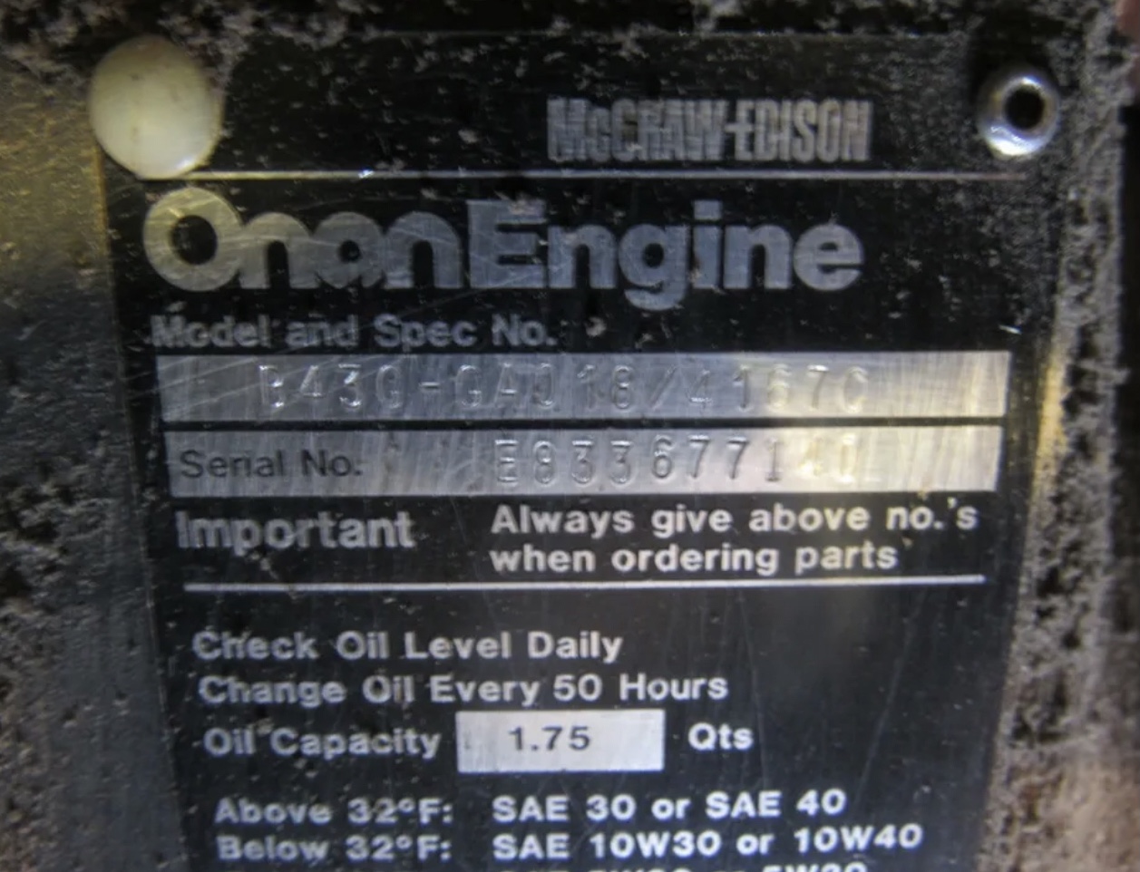

Hmmm! From your photos I think not 😂
It was one of two attachments to your post that’s why I thought it was a joke also . Very strange . Now going back over post can’t see them .
A few years ago on this forum random pictures would sometimes attach ......
Ghosts in the machine ?
hack?
hack?
That’s exactly what must have happened there . I did think it very strange
hack?
thats exactly what must have happened here as they now seem to have disappeared .
