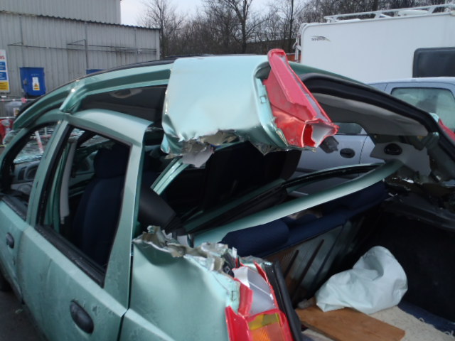

quite a bit
i had to take the roof off
:D
