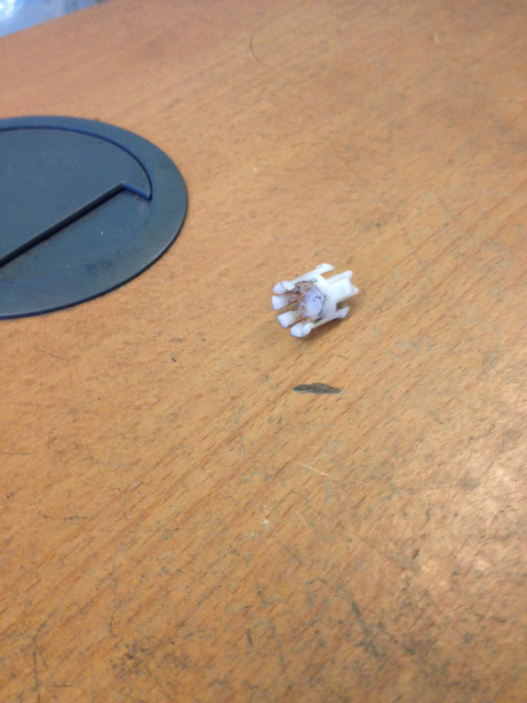

I had the same issue and it was the result of a silly little piece of plastic connecting the ball joint to the clutch rod wearing on one side ! ImageUploadedByFIAT Forum1405424254.162002.jpg
I had the same issue and it was the result of a silly little piece of plastic connecting the ball joint to the clutch rod wearing on one side !View attachment 140464
That's exactly it! The exact same thing for me also, it's all fixed now and I know what the issue is if it happens again :). Thanks for replies.
