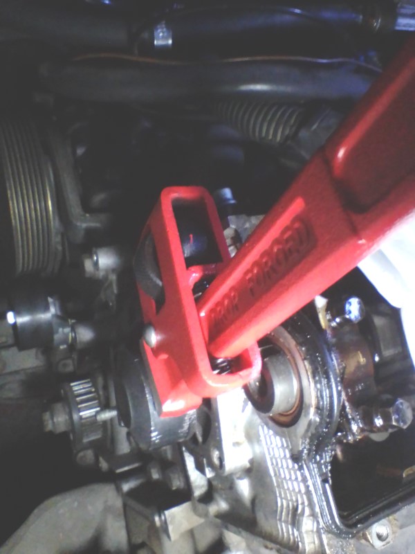

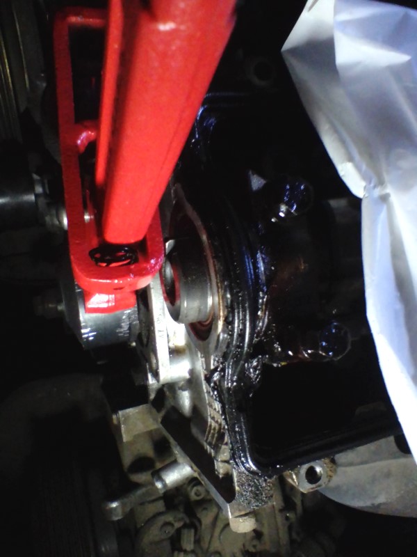

The new water pump fits about 6mm and carries a slim channel for the O -ring. The old pump is stuck, I removed all the glue or universal joint of silicone from outside. I don't remember well, but I think that old pump can be the original '96.
By draining the antifreeze fluid circuit, nothing of oxide has come out, all clean and bright green.
Theoretically it should be something that comes easy with your hand. The problem is that I can't get it out. I have used the Stillson tool and the pump does not move at all.

Hi did you manage this as I have to get this done was this possible without removing the engine? Thanks
Yes, I managed to extract the water-pump.
I had to make some cuts at the edges of the pump with a "dremmel" tool, with the 1st intention of pull, cut and extract a higher segment from the top, but I couldn't. But this cuts let to support a chisel and hit it with a hammer longitudinally in the sense of the body, until the pump gets rotated, in a clockwise and anti-clockwise.
You have to be very careful because the accommodation wall in the aluminum motor block is very thin.
Patience and luck!
