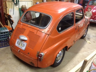

Thanks for the replies. I am working on getting some pics for you. Not the prettiest thing right now but hope to get it up and going by The end of the year
Doesn't look too bad and if it is at least the bodywork will be shared with the Fiat 600.
