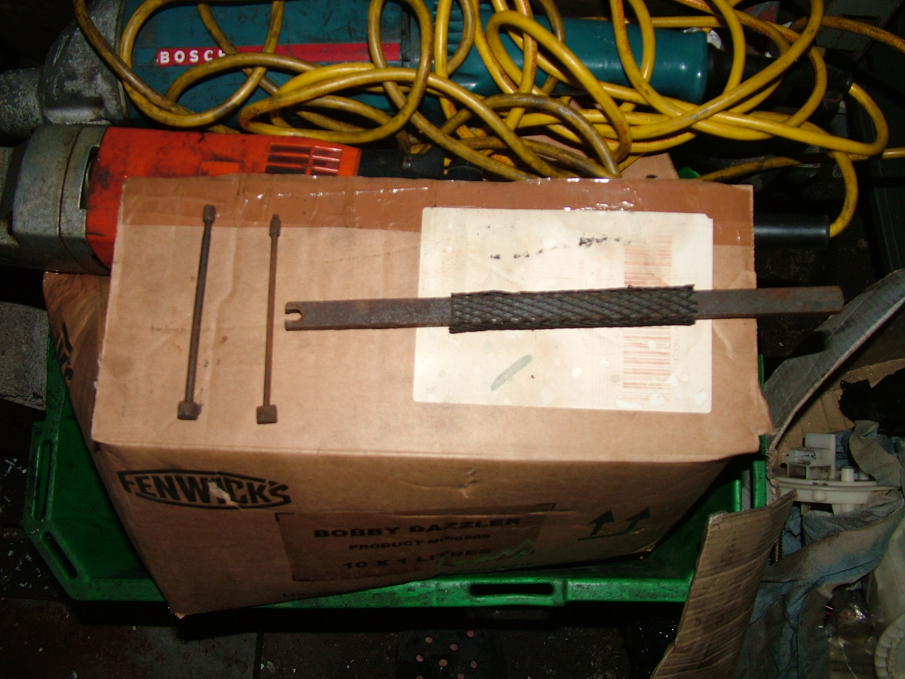

Re removal I am guessing that if similar to many cars that era you drive the "roll pins" out of the hinge, basically a spring steel hollow pin with a "slit" down it's length.
There is a special tool with different size threaded pins that drop down inside the hollow then engage with a slot in a square bar that you hammer and the pin should slide out. If that sounds familiar let me know, as somewhere in my garage I have the tool so a photo of it may help identify what I mean.
I would say don't be tempted to use a parallel punch or similar as it will make matters worse.
Thanks bugsymike a photo would be great
It's been sat in a damp garage for years, simple but did the job.
You hit the square bar as near to the pin as safely possible whilst holding the other end firmly.

I was thinking of the hollow split roll pin type, so my tool no good, if yours is like picture then that tool looks ideal.:)
