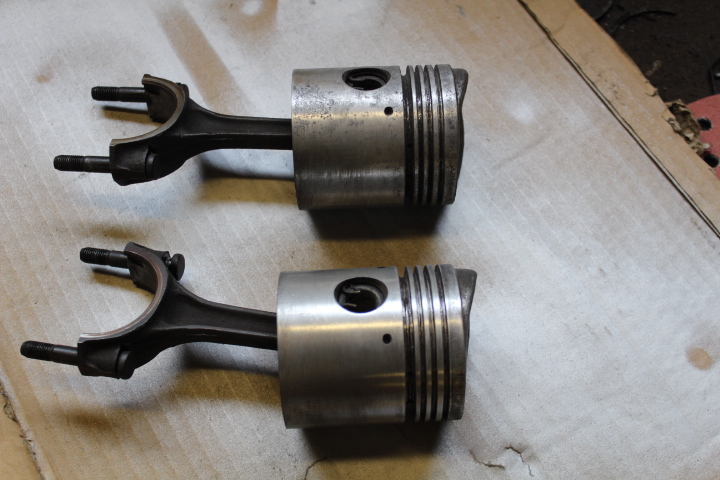

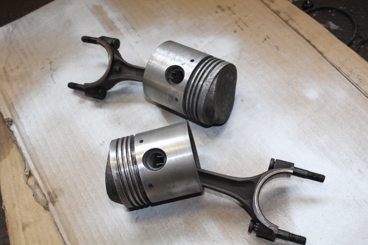

I checked the size they are 67.4mm diameter, so standard size but yes they look like the early tuning ones that I think The hobbler mentioned a while ago. So really hope I can save them. Only problem being if I can reuse the cylinders as the later cylinders have the recess and use a different gasket so not sure if they are interchangeable.

So if I can save the Pistons but need new cylinders, I could use the cylinders from my L & use the original D head?
yes, of course. 500D and 500F/L have 499ccm and absolutely the same bore diameter. I hope you can safe those pistons. But you first should try new piston rings if they fit.
But tell me: why would you use new cylinders? are they damaged?

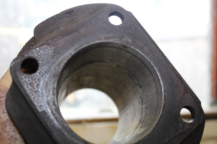

I have only managed to remove one piston as there is corrosion in the cylinder and the other one won't move. So they may need machining to remove the damage to the bore wall. This will mean the Pistons will be too small. So I will need to fit different Pistons or fit different cylinders so I can use the original Pistons.
I have a pair of 500 barrels if they are required (came plonked on top of the pistons on the 595 engine I have). they will need a good honeing, or possibly a bore-out to the next piston size.
Sean, I have been known to have a leaning towards retaining old bits of a car. But I would cut my losses on that one and just get a new set of matched pistons and barrels, possibly even a cheeky set of those 540cc ones.
From my experience with the corrosion-seized ones on my 500, yours will need boring. So the pistons won't fit even in the unlikely event of them being OK. Mind you, I also decided the original Fiat quality was likely to better so in my case I had the barrels rebored to fit the next sized but one pistons. It cost me nearly as much in the end.:bang:

I have got one piston out and the bore looks to be ok and should just need a hone.

Problem is the shape of the piston crown is not flat. Check the photos.

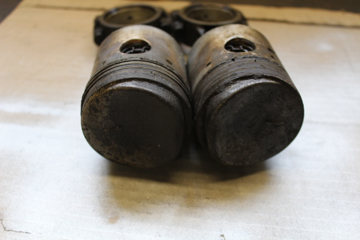

I am glad to say that the other piston is now out!
I have heated, cooled, hit it, soaked it in oil, petrol, White Vinegar, Rust eater and WD40 and set it on fire!
Eventually I had to mount the cylinder in the largest vice I could find clamped around the lower section. This was risking damaging the machined face that sits on the block but it was the only way I could hold it still.
I then shaped a piece of wood to fit in the bore with a rough shape of the piston to spread the load. Whacked it as hard as I could with a large hammer a number of times and it moved!
Finally got it out to find that all the rings were rock solid in their grooves. They were completely packed tight with carbon etc.
I managed to remove the rings - broke a few getting them out and then cleaned the grooves out with a small screwdriver and part of the broken ring as this removes the crud and cleans it completely out to the point that the ring fits the groove again.
The oil control rings were solid. I'm surprised any oil got through to the rings from inside the piston. The pistons have cleaned up fairly well.
There's some slight pitting from corrosion on one of the pistons but I think it will be ok.
The Cylinders are both slightly damaged from the rings/corrosion. There is also a slight lip at the top of the cylinder although I am thinking this is from the original pistons as the top ring on the high compression piston doesn't go up this high.
Next step give everything a quick clean then take it to the machine shop to get them to put everything in their cleaning tank and then check and diagnose if these components can be used again.

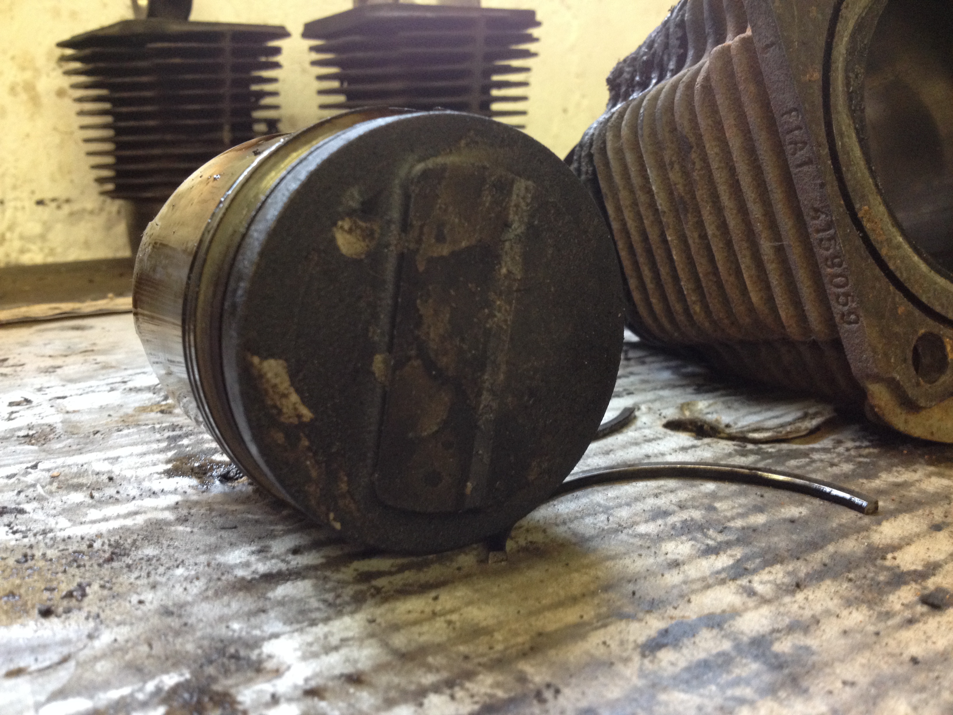

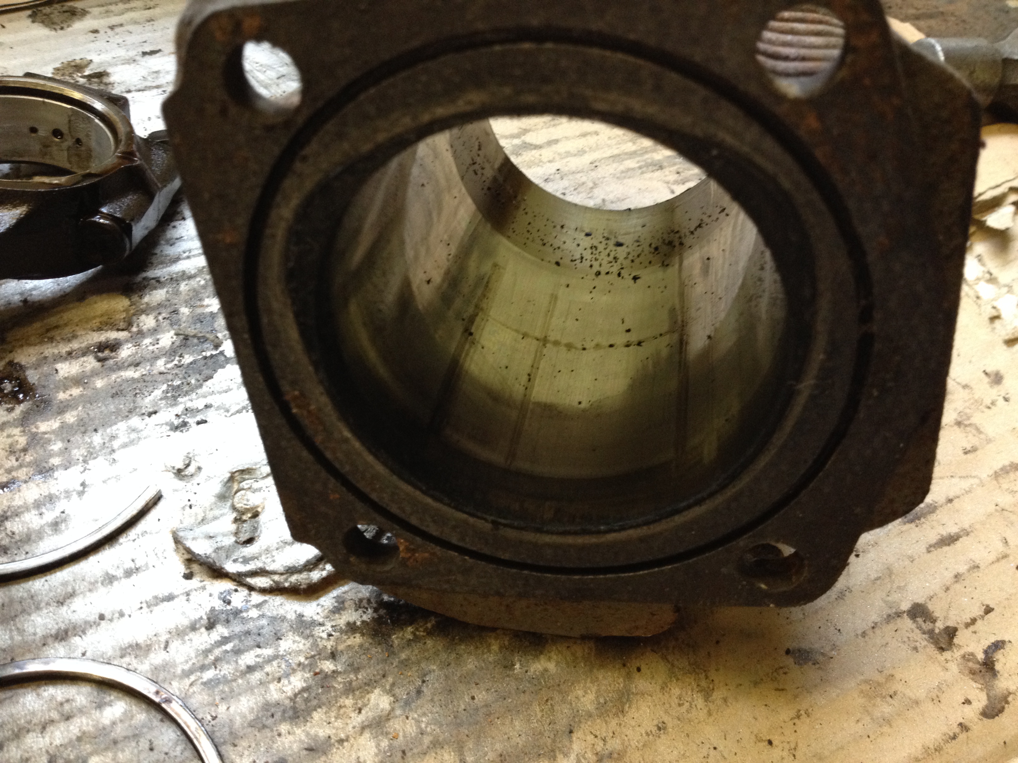

Then came the pistons. Now I was expecting 67.4mm. Oh no, appears that the bores are approximately 70mm diameter and another set of high crown pistons. The pistons look good but sadly the bores have scores going up one side and the piston ring was broken. So I think these cylinders are finished. But maybe I could have my D cylinders bored out to use these pistons instead.
Has anyone any suggestions as to what they are and what cc this will make it?
