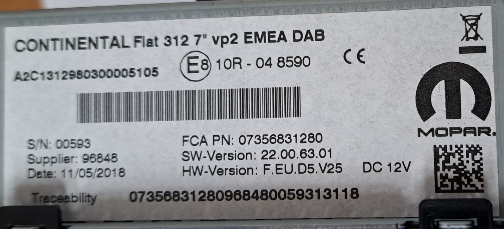

Hello,
I have a fiat 500 2018 with te 5" uconnect.
Now i want to swap it with a 7" .
It's a continental Fiat 312 7" VP2 EMEA DAB
Now is the question , does this unit have carplay or can it be activated on this unit?
Please help me.
Thank you.

U wont it has Carplay until to fit it. But if not you should be able to code CarPlay to it. But u will need 7” surround and a radio code. Once fitted do proxy alignment
