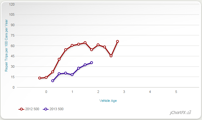

To view the new graphs, select "reliability trends" in the breadcrumbs at the top of the linked page. Or check out the attachment.
Updated stats soon for the 2012 and 2013. We continue to have far fewer owners signed up for the 2014 and 2015. I'm hoping some people here can help fix this, so we can see how recent model years are faring.
