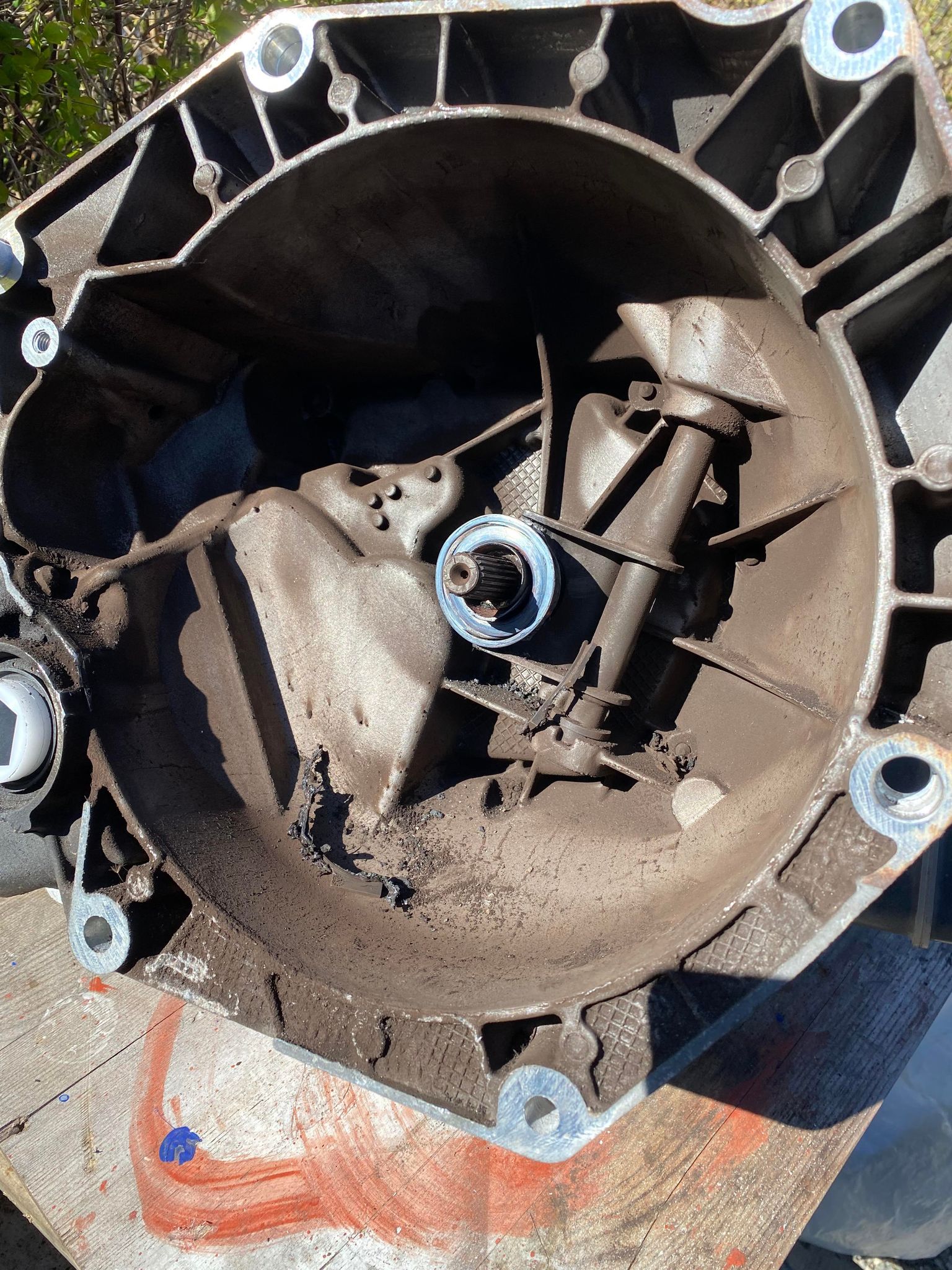

The car is parked because of the noisy bearing and I have been working for a few days to take off the gearbox to access the thrust bearing.

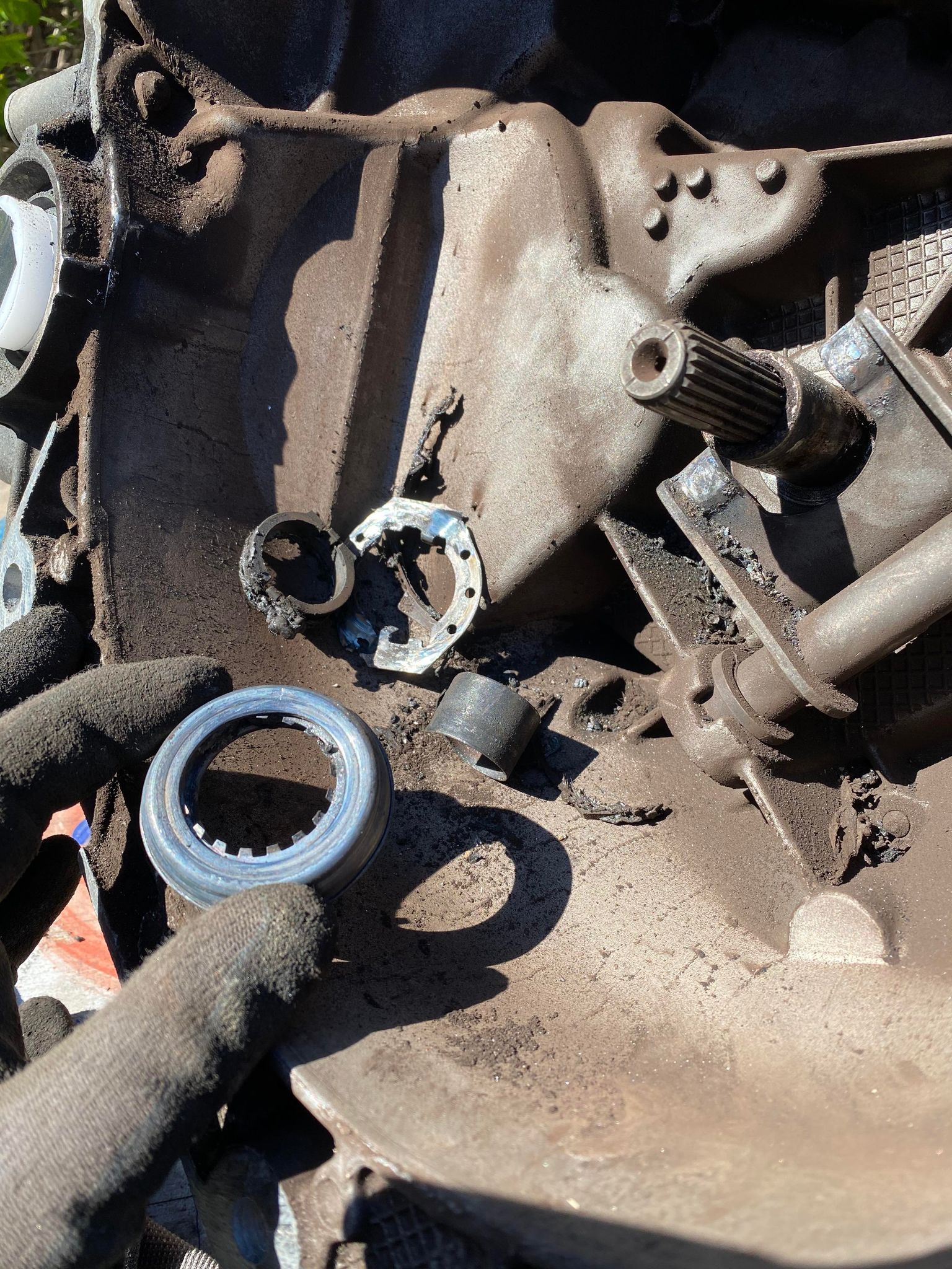

Worst car i have ever worked on! So tight!
As you see the bearing has failed completely.

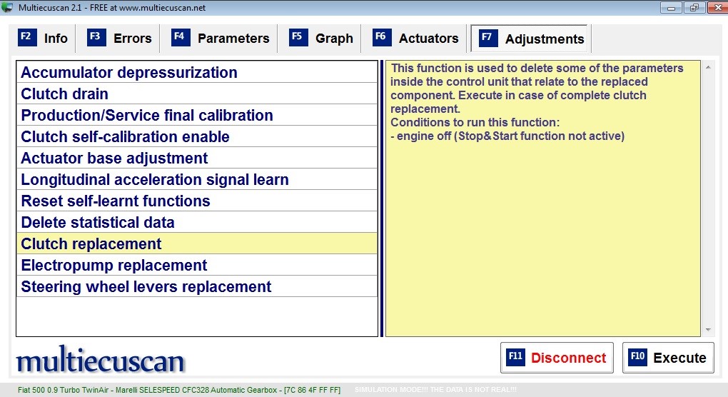

Still waiting for some parts and a new OBDII interface. I will install a newer version of Multiecuscan on a new PC but looking at my old PC i found this menu for the Dualogic. Which one do i use? Clutch replacement and Production/service final calibration?

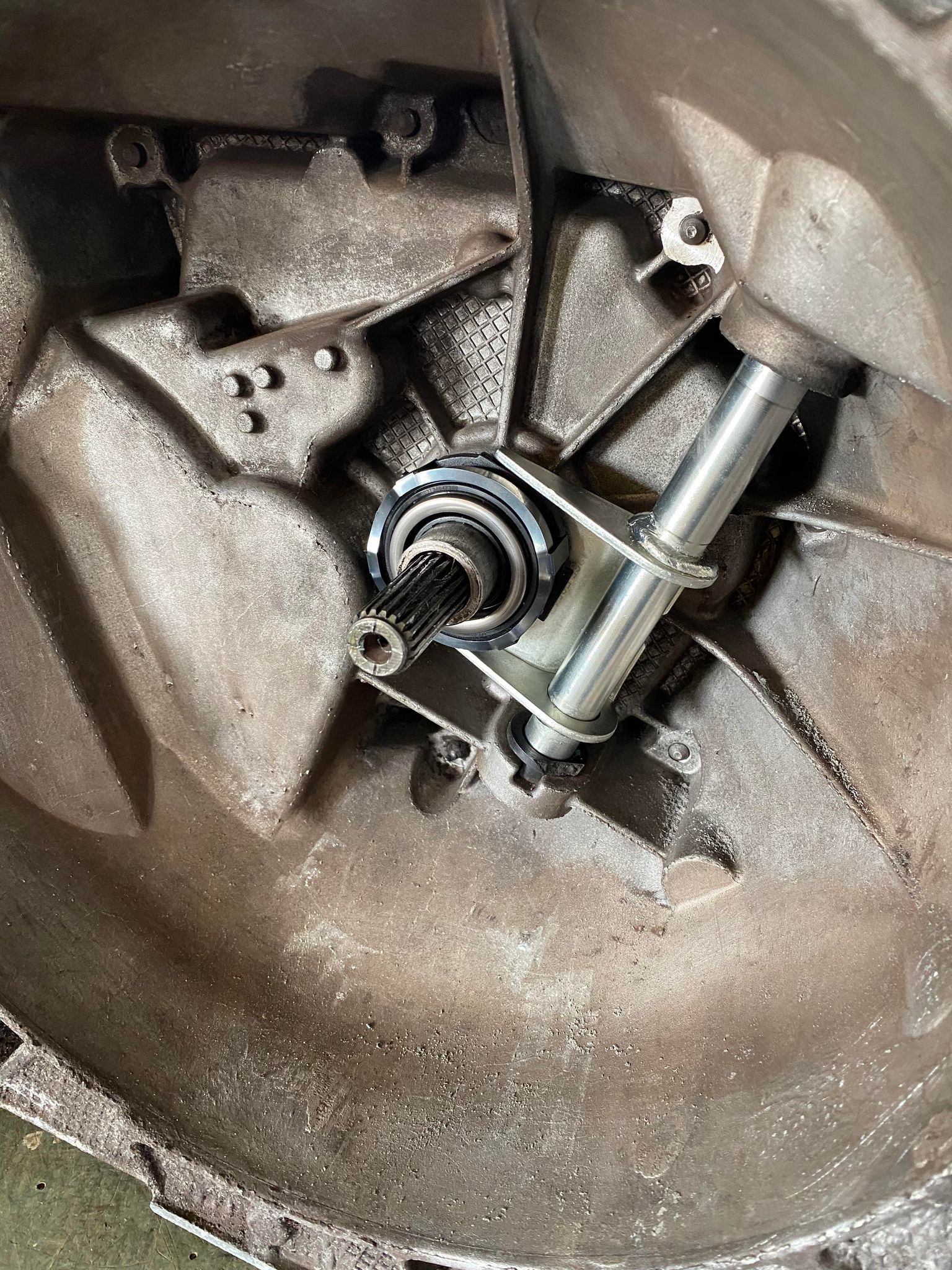

New clutch and thrust bearing in place. Installed a new clutch-arm and top bushing.
Did also replace the seals for the driveshafts while i had the gearbox out.
As 'puntodeltathema' suggested i did the following procedure in Multiecuscan :
Clutch drain, Clutch self-calibration enable and finally Production/Service final calibration.

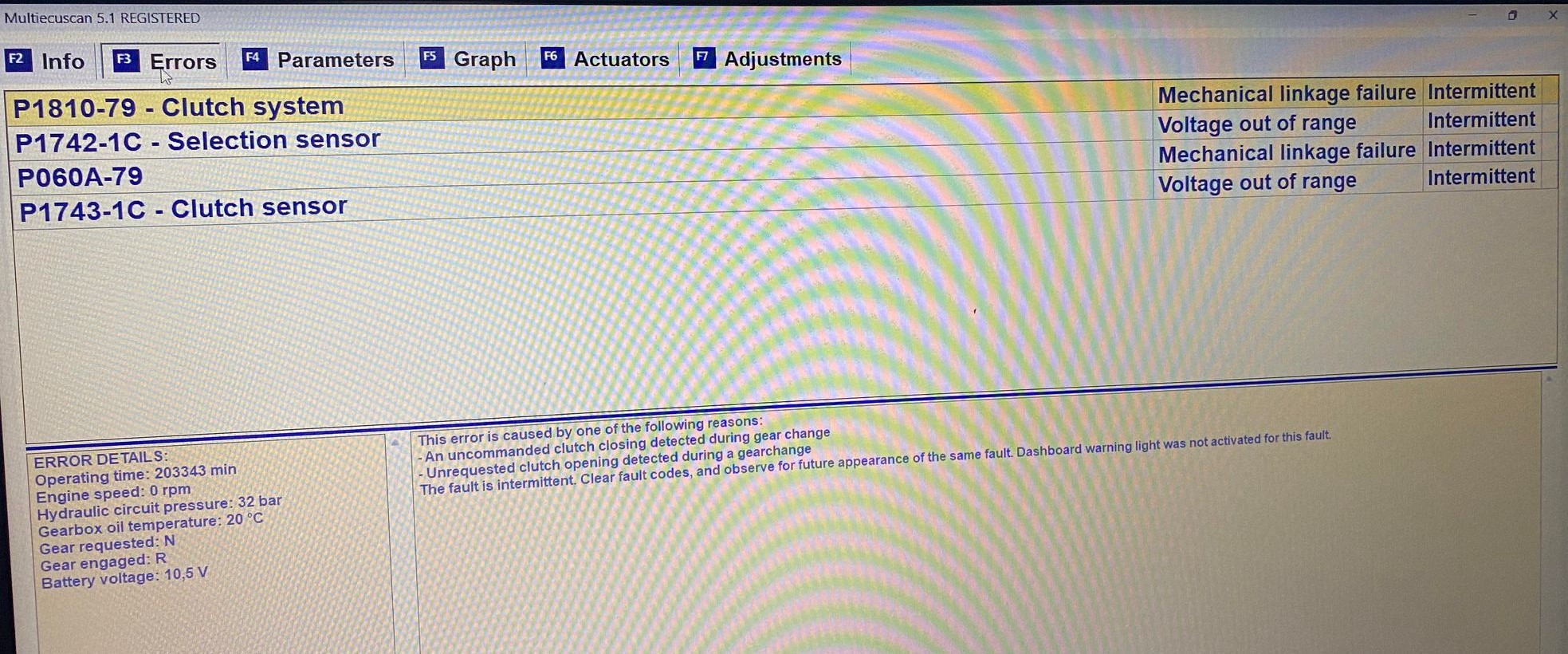

These are the error codes stored BEFORE we replaced the clutch and thrust bearing. All because the Dualogic robot had to struggle with a worn out thrust bearing.

A worn clutch on these cars gets to the stage where it will not release regardless of how much pressure you put on the pedal. The Duologic an be very rough on clutches so I expect many "gearbox" errors are caused by this issue. The slow start from neutral means stopping at junctions (etc) in gear is the only useful option. But try to avoid too much creeping forward. It mimics the old style "slushbox" automatic but that really wears the clutch.
