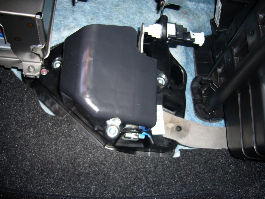

It does look like there was a slight design change Liam, there is a slightly larger plastic shield around the bar in my car :)
Here's a picture of the upper passenger footwell arrangement in my car. It's a 2010 model.
Click to enlarge if you want more detail.
Personally I think this is a load of fuss about nothing. If your passenger manages to operate the brakes using this bar whilst the car is still moving, you should post the details in the Kama Sutra, rather than this forum.
I think the older models didn't have the raised black plastic bit around them. Mine is an 09 and looks like that too :)
I tried as hard as I could and could only just get the brake lights on......
So I can't see the issue then like you. IMO there is no 'dangerous' defect. Iirc TDQ said she could get hers to stop dead at 5mph, but at that speed next to no pressure is needed to stop the car anyway.
I really can't see what the big fuss is about.
In that case i take it back. From looking at the photo posted i'm inclined to agree that it's a fuss about nothing & maybe just early models need looking at.
Thanks for clarifying (y)
