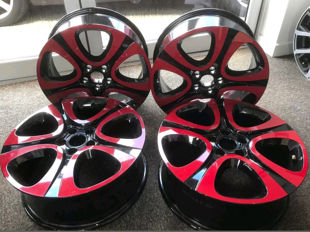

Hi. Newbie quickie!! Does anyone happen to know if the Fiat 500 5 stud pattern is the same as the 2010 onwards Doblo 5 stud pattern? Apologies if this has been asked previously. Cheers, Rob.
Hi Chris. I am looking at some that may be Abarth! Not sure.
To answer the question though, the Doblo is 5x98 so anything with that bolt pattern and a centre bore of 58.1mm or more will fit.
