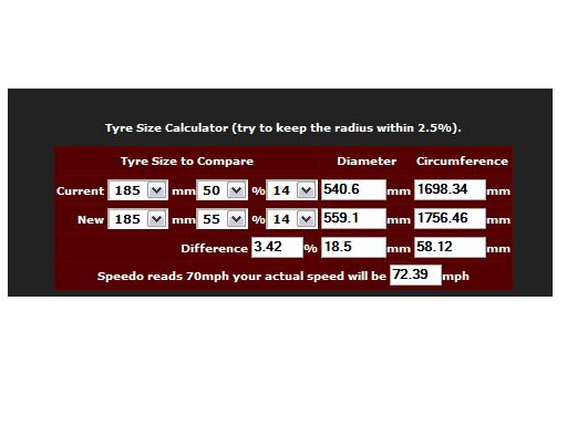

also by going to the 185/50's your speedo should be more or less bang on accurate (for some reason on 175/50's my speedo reads 4mph under - I'm guessing Fiat did this deliberately).

Probably going to go with conti-contact sports - not the cheapest but I've heard good things (though saying that Yoko's clock in at about a tenner less per corner at the moment, so Might go for them).
