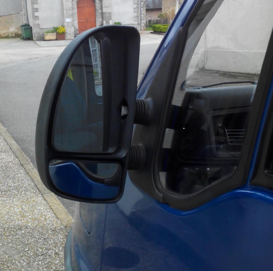

I need to do something about my LHS door mirror. I have a RHD van in France and at some junctions I have zero visability on my left at some junctions. Is it possible to replace the current single flat mirror with a mirror from a later model with the built in secondary blind-spot mirror. I have seen one swapped on a Peugeot boxer but I don't know if it is a easy to do in a Ducato. This photo of Bluemu shows the general mirror type I'm talking about.
https://www.fiatforum.com/gallery/showphoto.php?photo=80358
You can bolt them straight on but most are electric adjust so you may want to look for manual.
Thanks corcaí, the one for sale is non-electric so I'm very optimistic about it. I've just ordered it and I'll put up an update when and if I get it fitted. The seller offered me a full refund if it doesn't fit so only my postage is at risk.
Just in case anybody is interested I was able to fit a 2005 non-electric mirror onto a 2000 model with absolutely no difficulty. It took literally 5 minutes to do now I can see safely at junctions. Well worth the small outlay.
