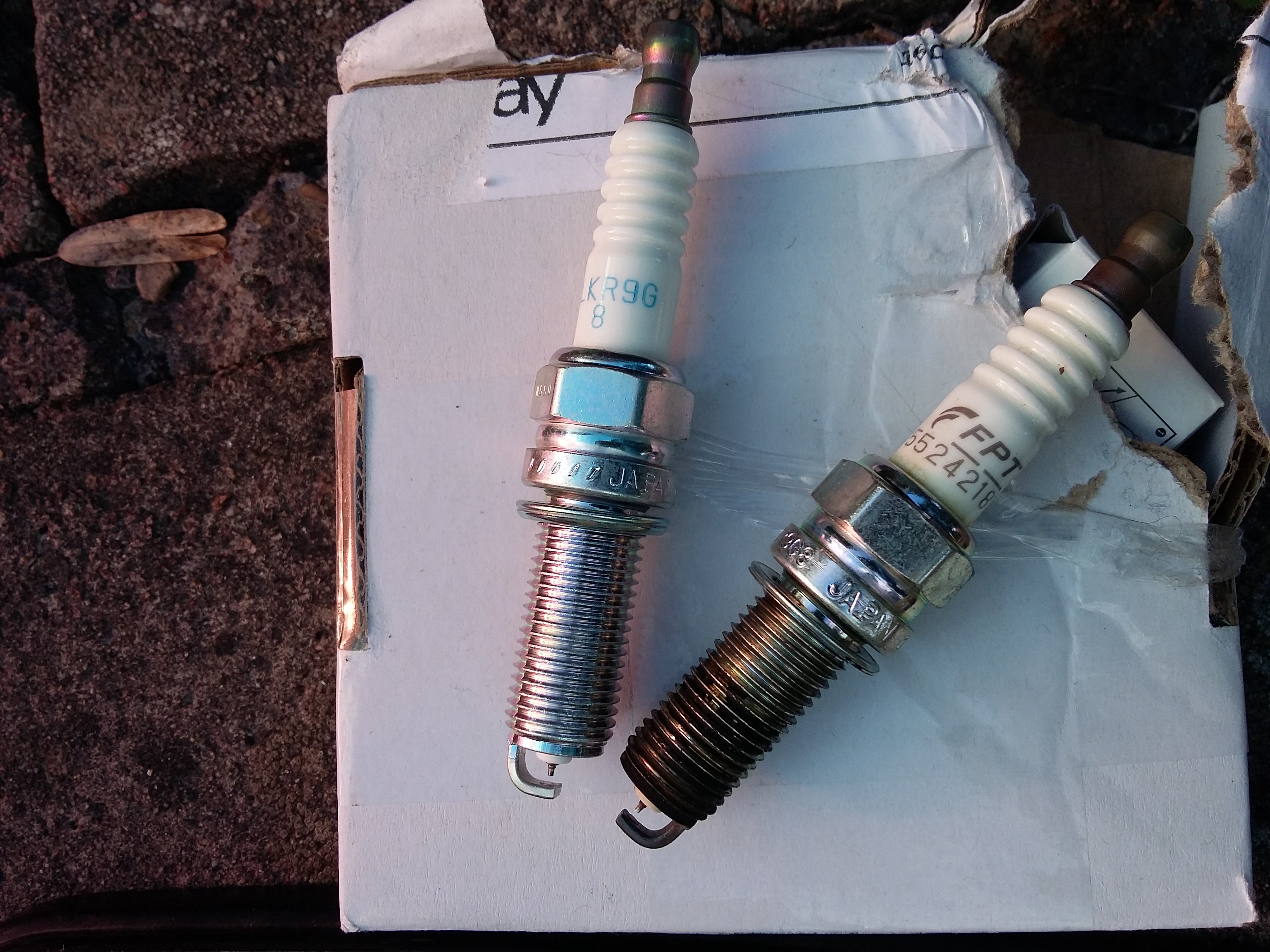

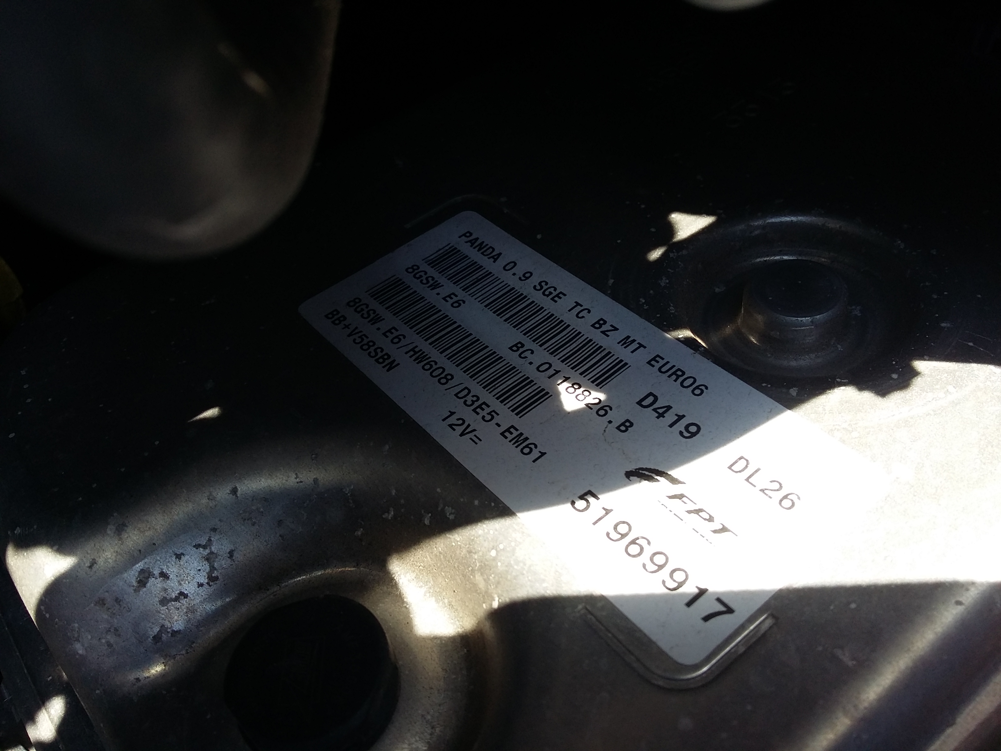

Well.. the 1st task showed plugs that were not too clean.. and a Euro6 ECU
It has been suggested the half.warm poor fuelling could be down to the 'mk1' Euro6 map

Plugs made no difference..
