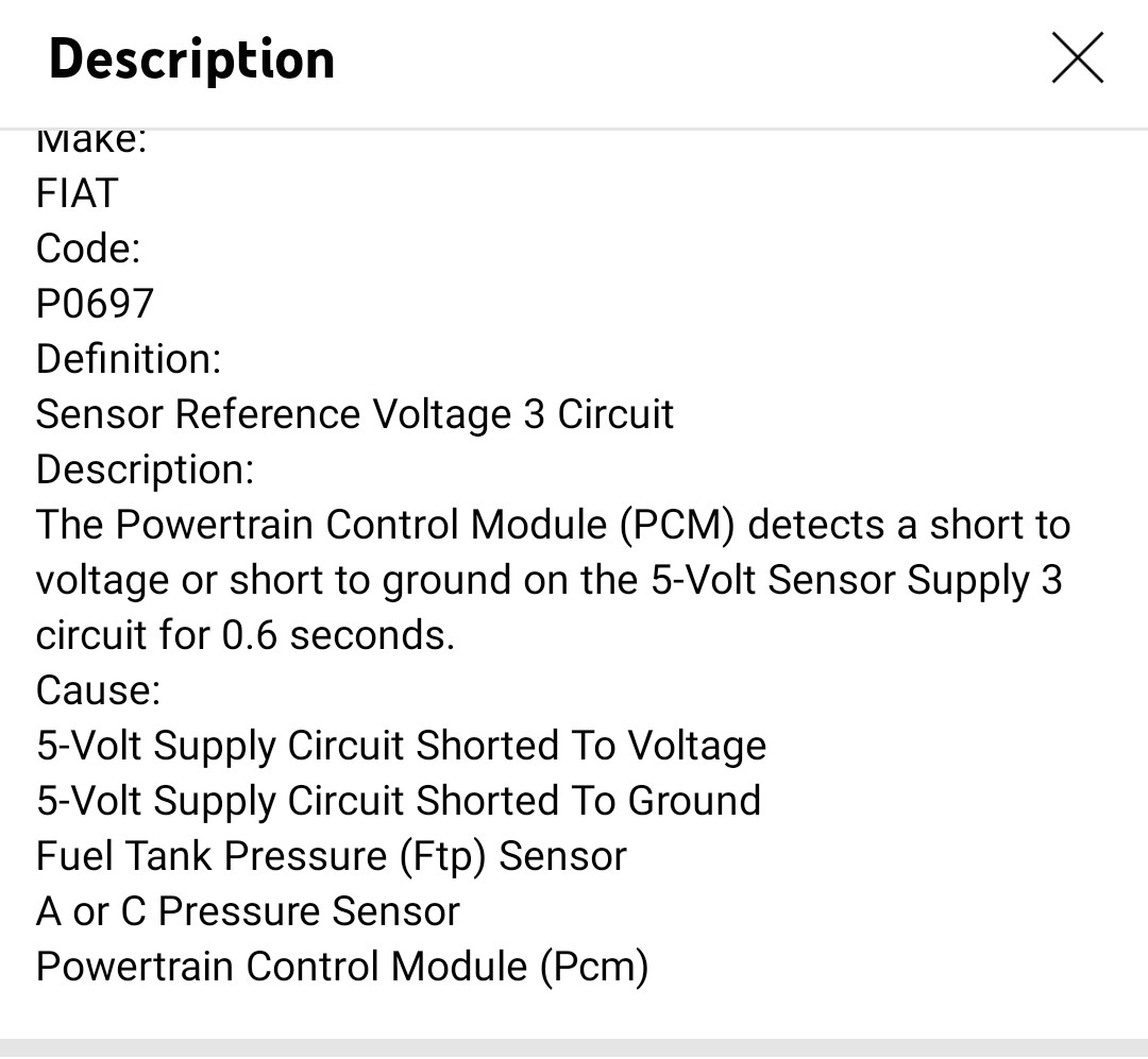

Hi, this morning started car and after about 30 second engine fault error message on dash.
I have had the AA read the error and it is P0697...
Have no idea what is wrong, but the car has a loss of power now. Any help please would be much appreciated.
