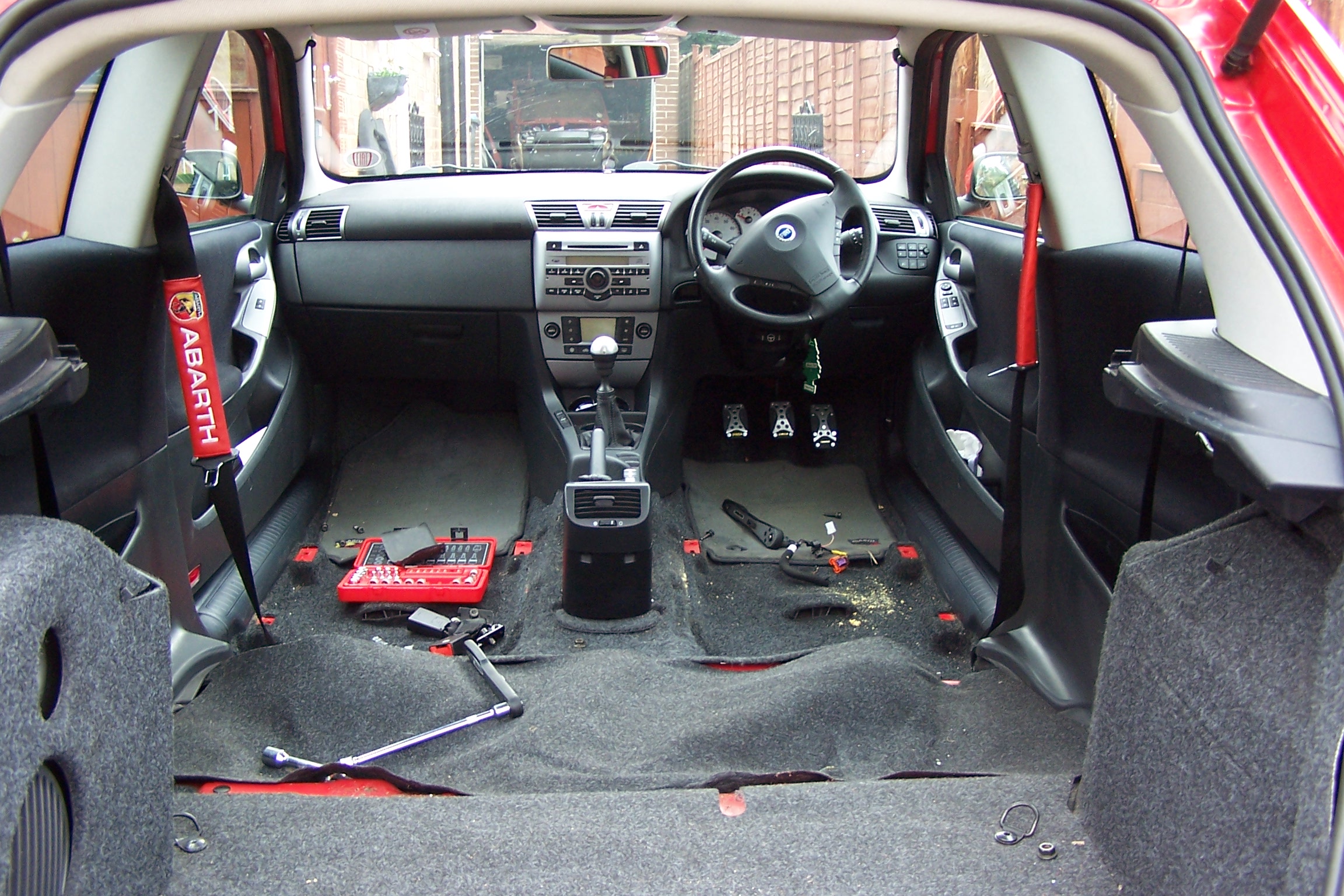

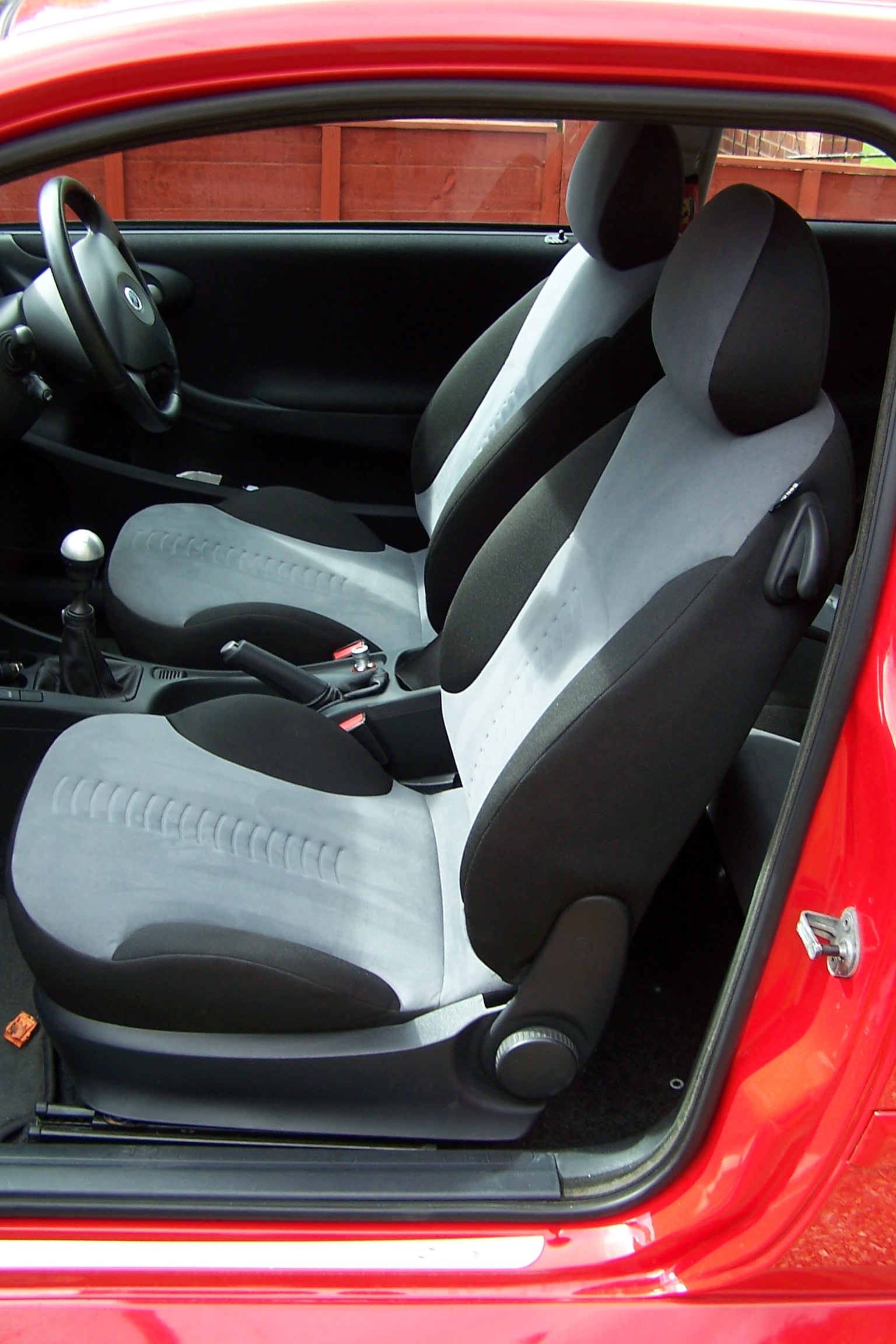

ok, purists look away, i may well have committed a crime! my old seats were looking a bit sad ( especially the drivers one where the bolster had collapst:( ) so when these turned up on ebay, a couple of bids saw me the owner of a new set out of alcantra seats out of a stilo sport ( never heard of one? ) that had one done 16000 miles, so no sooner had they landed at my castle Gadge, they were quickly installed and ready to use! (y)

I actually like that look. Will be interesting to see how well the Alcantara wears.

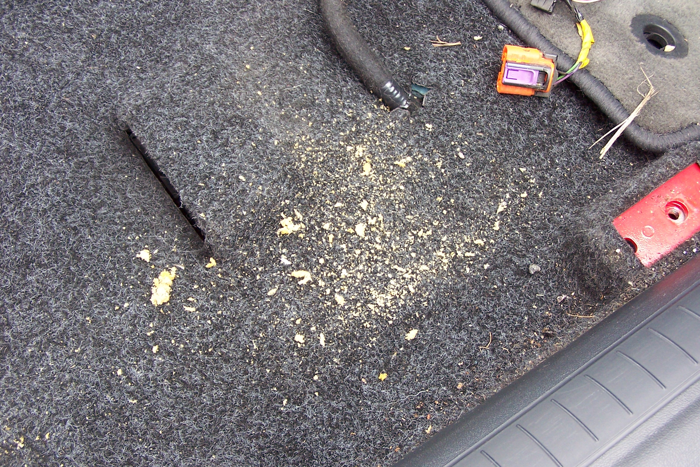

Looks like you had a squirrel nesting under your driver's seat!
haha! yeah thats what i thought!! its actually all the old foam from the seat cushion where the bolster was literally crumbling away! proof that it really did need sorting! :)

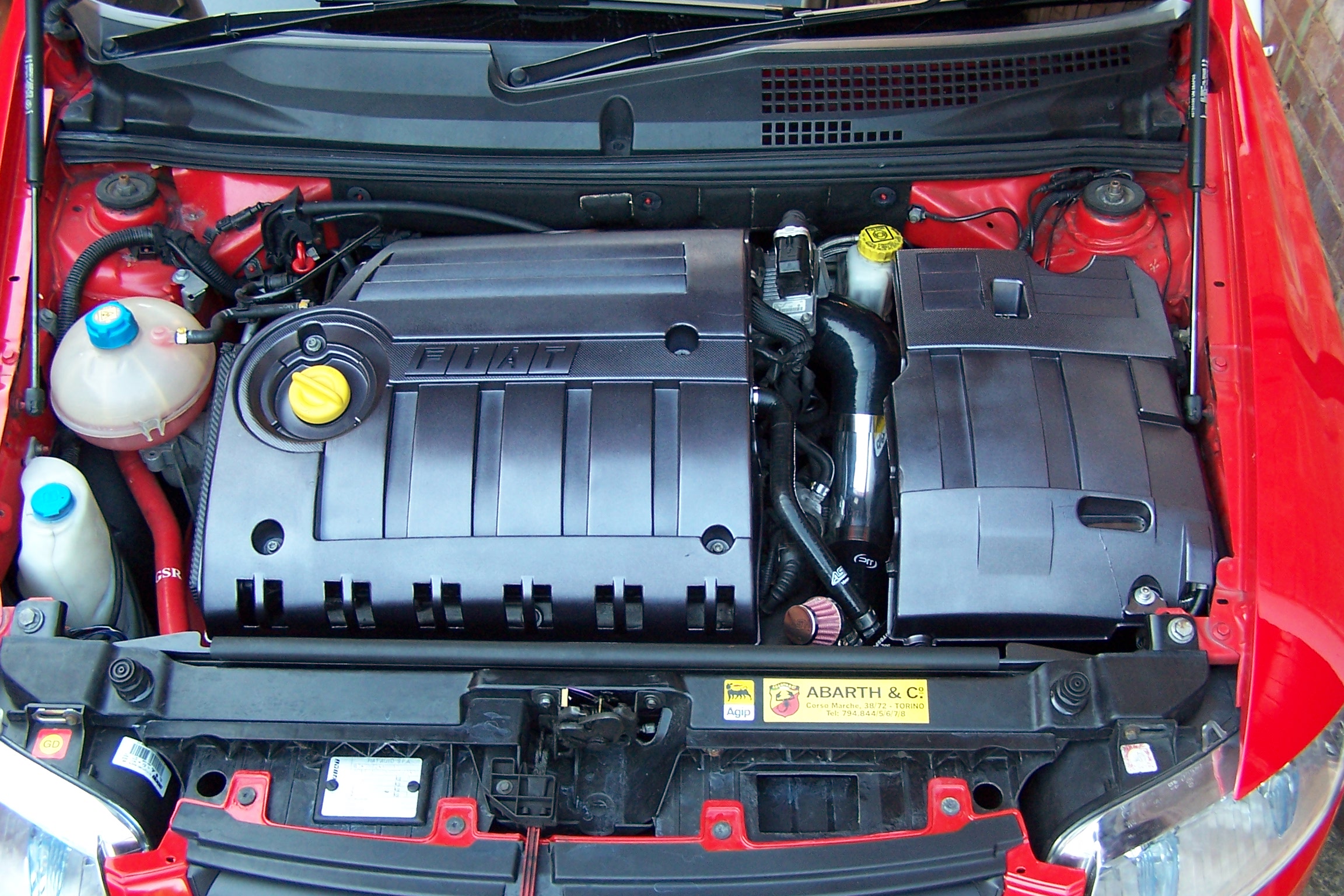

ok, so more bits and pieces done. i went ahead and replaced the old GSR induction pipe as it was starting to wear by the gearbox and never quite fitted the airbox properly (plus i did'nt like the red;)). i decided to go with the traditional slicone black look but with a polished aluminum pipe and whilst i was at it, i fitted my new oil catch tank. its an atmospheric type, so no oily fumes going into the engine (y). i also repainted the engine and battery cover to an off black metallic colour caled amythis most comonly found on alot of 90's rovers...... got some before and after pics here

Nice work Gadge. Wish I could have fitted in my OCC that close to the induction end. 'Cos I've still got the OEM induction hose, my OCC is over the other side of the bay, next to the washer bottle...which means rather more pipework than I'd like.
Incidentally, on closer exmination of your pics, it looks like you're only redirecting half the vapours. Did you know there are two emissions outlets from the cam cover to the inlet side? The one you have covered is upstream of the throttle, the other is downstream.
Look at the hose betwen the throttle valve and the inlet manifiold and you'll see it. It's outlet No 2 in this diagram:
