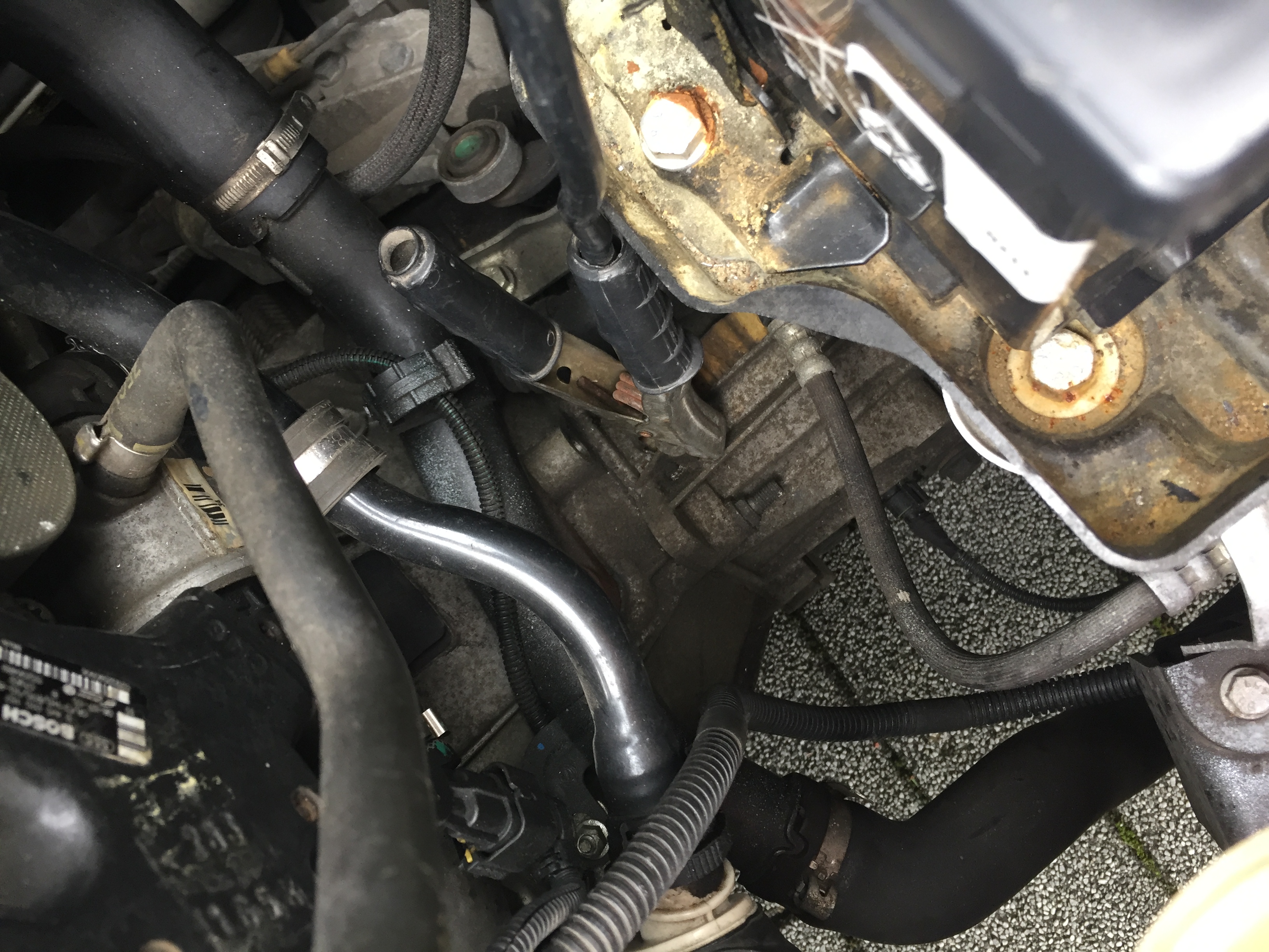

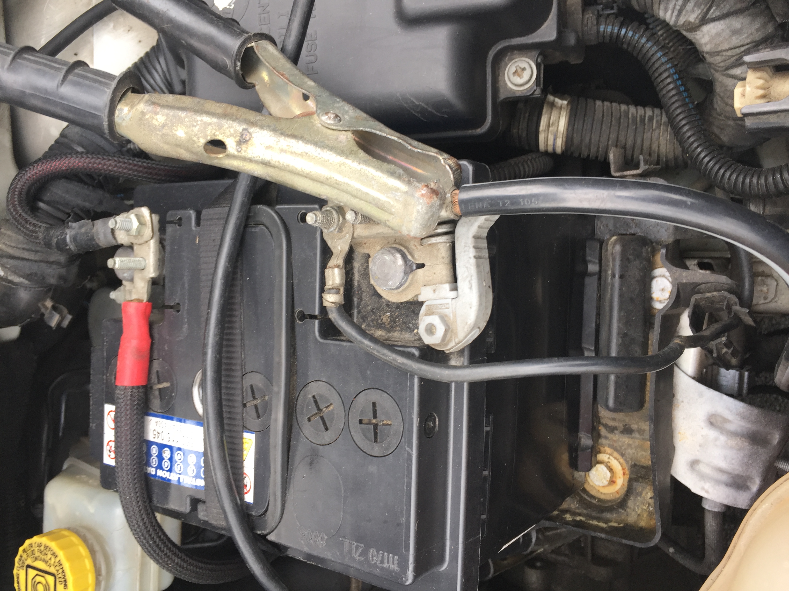

Have you tried to JUMP start it (with your battery hooked to another car)?
If the recovery Guy did try to jump another battery to your car, it means your battery is not the reason of your problem. Here's the next test as Rally5 suggested:
Using a battery jumper cable, connect the GROUND port of the battery (the black cable) to a metalic part of the engine (or gearbox).
- if the engine now starts, you have a bad (roten) ground cable, replace it
- if the engine still doesn't crank, the starter is probably gone, OR its connection to battery positive is bad ...
BRs, Bernie
