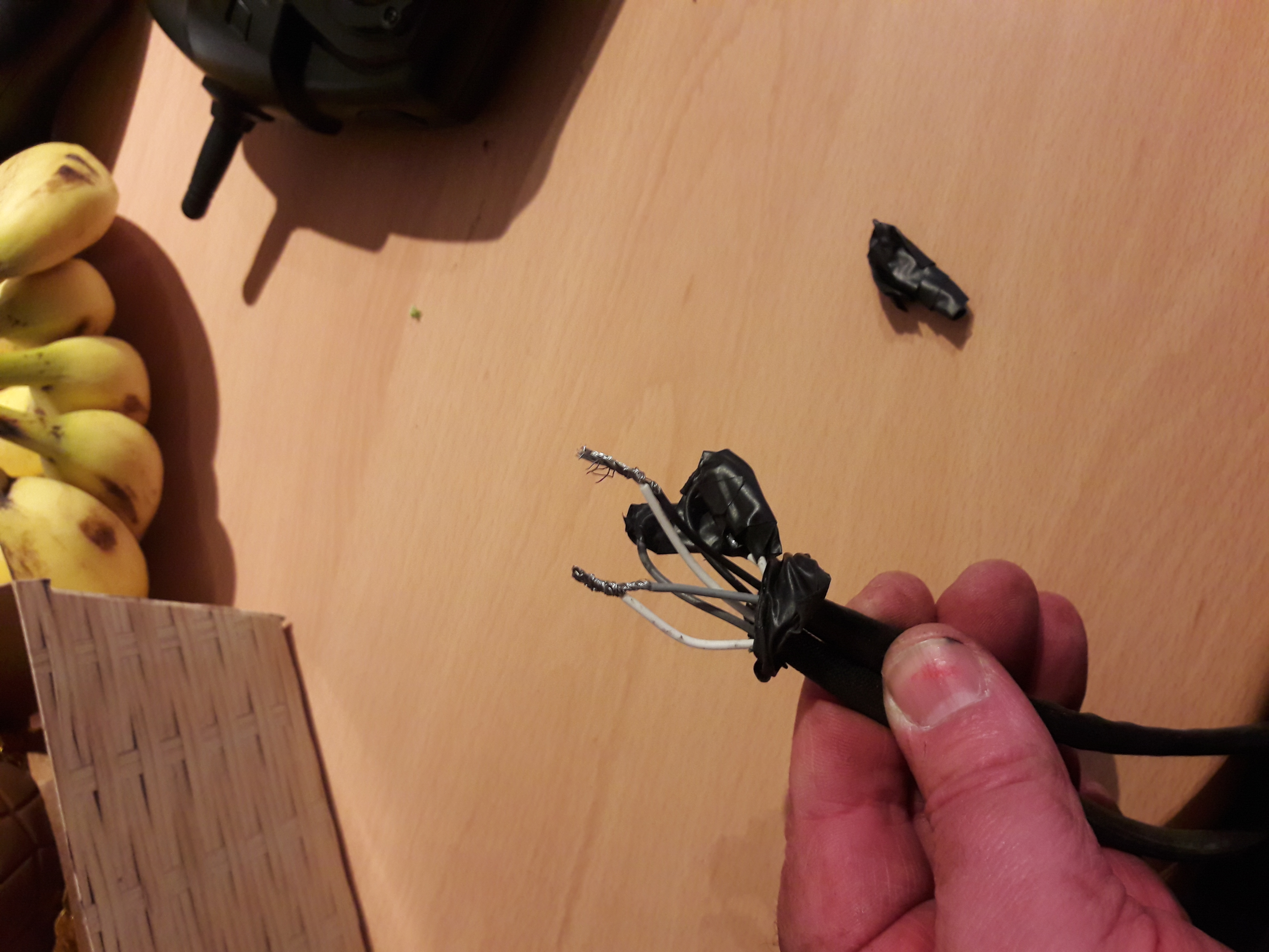

Get a good one with the connector pre-fitted. Don't try to save money on a universal one that you have to splice in or fit your own connector, the voltages are critical so you don't need dodgy connections.
Like this?
