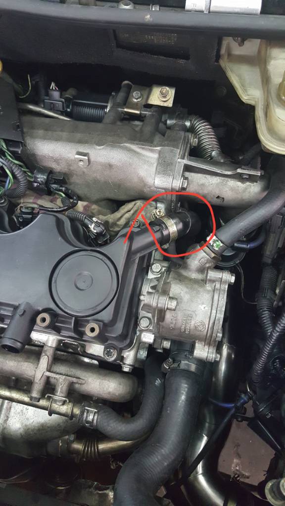

I tried to remove breather pipe from cylinder block as in attached photo and the pressure seems ok. Put the pipe back into rocker cover
..wait a few mins. I then heard hissing sound inside rocker cover.
Could be the rocker cover melted inside and blocked the air from escaping?

But where does the other end go?
The crankcase pressure has to be vented. On a normally aspirated engine it goes to the inlet manifold, or air cleaner. On a turbo, it has to go somewhere on the 'suck' side of the turbo. Find that and check it is clear at that end.
