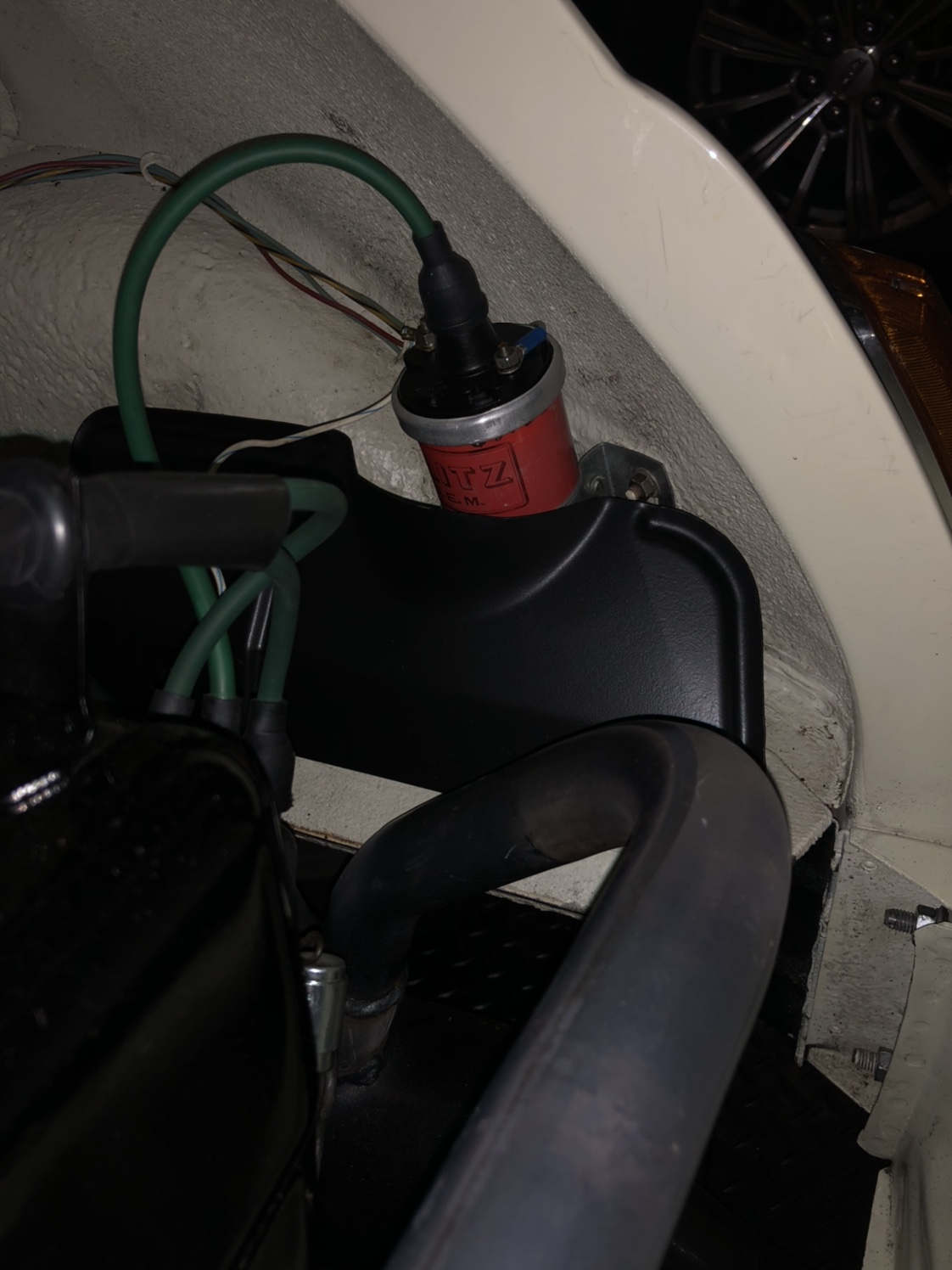

Edit: Just a quick note, this is currently my ignition coil . From forum research, it appears I should be using a Bosch Blue coil with my 123 Ignition System which is currently en-route from Pelican Parts. I doubt this is the fix to my problem (would be nice!), though I'm going to take a short trip tomorrow and see what temperature my current coil gets too, however this will be resolved in 1-3 business days if FedEx is to believed.

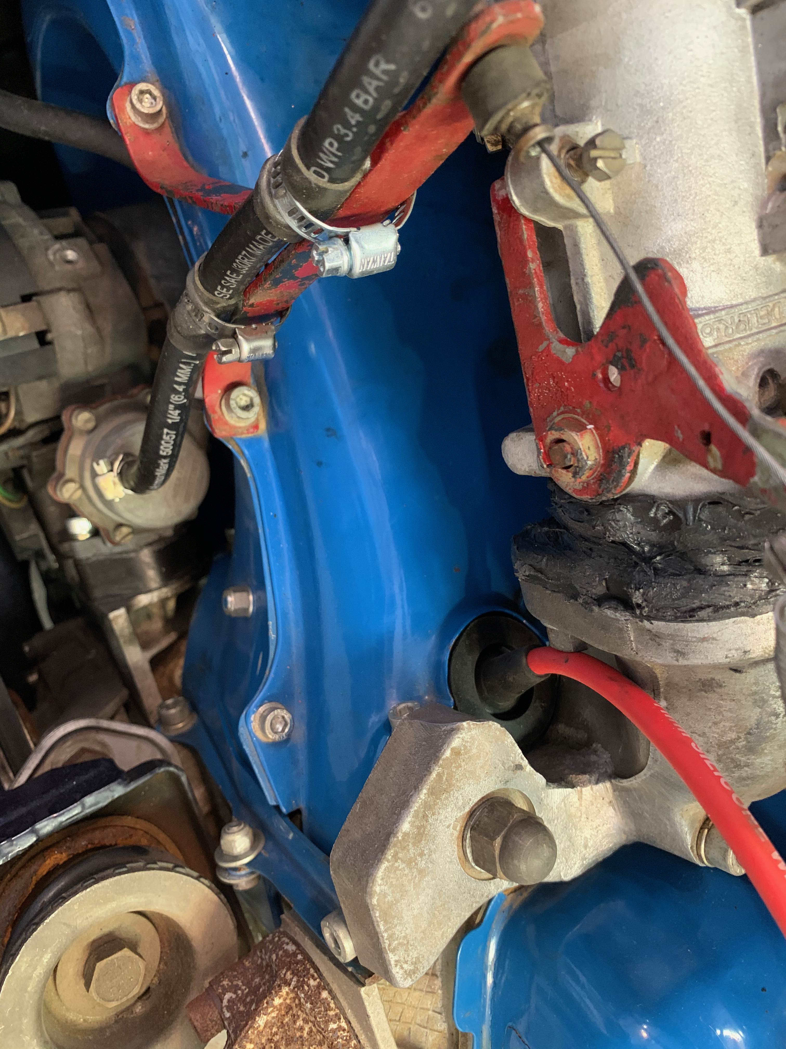

Regarding the thermostat, I think I misspoke. I don't have the output flap that allows heat to run into the cabin, that's sealed up on my engine, but I do have hot air blowing out on the right-hand side of the engine as the attached image shows. Now whether that air is existing the outlet immediately upon the engine turning firing vs upon warming up is a great question, i'll have to test that today. A spectacular failure is definitely not something I would like to experience, especially as that 123 ignition system was not cheap!

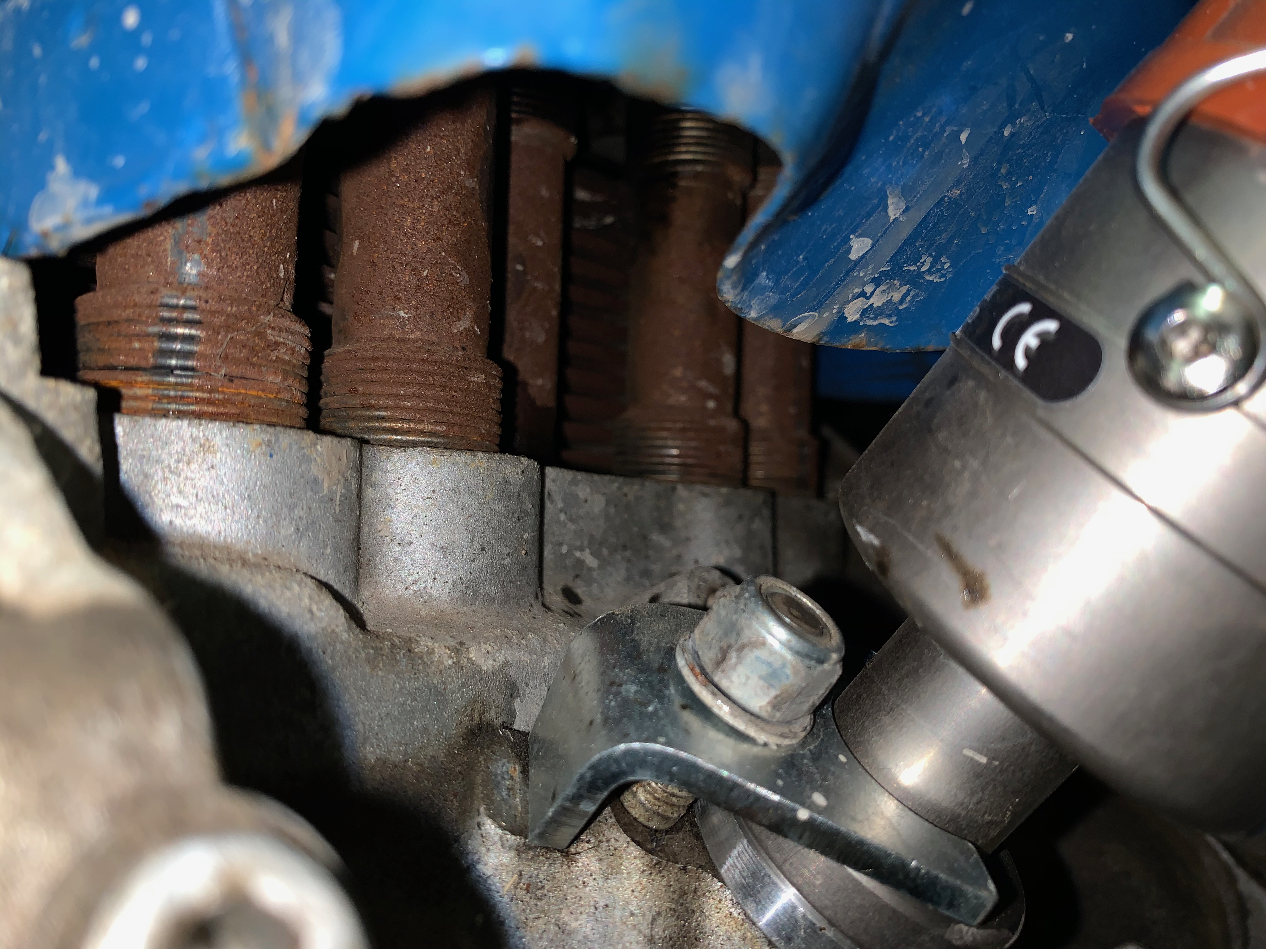

Looks like you have a Panda 30 head there and modified cooling tinware. If you have cooling air leaks on the spark plug side of cylinder head either from ill fitting tinware or no seals around the spark plugs it will not help with cooling and help to heat up that big carb & manifold.
Hi Toshi,
Thanks for the reply, identifying the manifold alone was very helpful! The tinware appears to fit together well, but there are no seals on the spark plug holes. I had order a cable grommet kit a while ago, and 2 of the grommets are big enough to seal the spark plugs, while not a perfect fit, it's pretty good. I'm going to test that out now, and look towards a better seal.

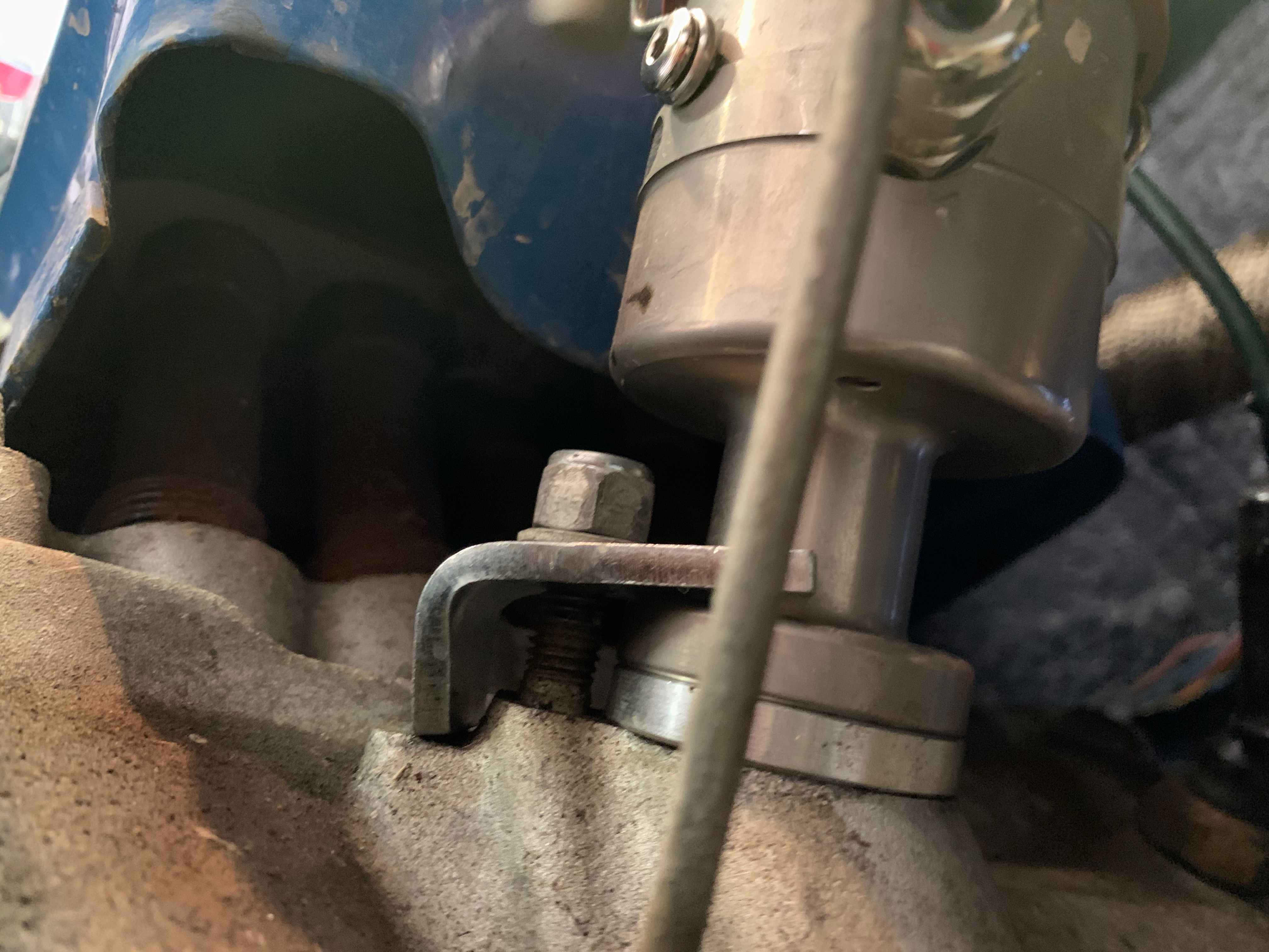

So I had a look between the tinware and the distibutor, and attached is what I found. Should the thermostat live in it's own enclosure that seals up that area?

I had the exact same issue and I believe for me it was the new coil I recently added to my new 650cc (converted from 500cc) engine. The thermostat and flap have been removed from my engine as well to allow for the larger muffler. The coil was getting so hot. I pointed an electric leaf blower to the coil and it started up after a few minutes of this cooler air being applied. So I changed the coil to an old larger diameter one I had sitting around and I think that solved the issue. I also inverted the heat shield to protect the coil from direct heat. Not sure if one or both of the changes I made is the reason but so far so good.

After a fun drive today, I did confirm that the coil is hot to the touch, not burn your hand hot, but difficult to hold hot. The bracket that holds the coil in place was burn your hand hot though.
Labman, do you have a photo of heat shield you mentioned? My coil is just exposed and I was thinking earlier of fabricating something to protect both the distributor and coil from direct heat.
Various suppliers can supply the correct spark-plug 'grommets'. They tuck in under the heat shield, so cannot ride up the plug. My advise would be to obtain the correct shrouding for the distributor side of the engine, complete with thermostat, and re-instate the heat-control flap in the back of the cabin. Looking at the pictures of your engine, I have never seen a right-side shroud that shape before! With everything correct, you might find that your heat problem is not as bad as it has been.

It sounds to me as it your coil is working harder than it should and building up heat. Check all leads plug extenders and wiring with a meter set on ohms to see if you get a high resistance somewhere .
I'll test the plug wires this afternoon for good measure, though they're practically brand new so I hope there's no issue there. Thankfully no extenders on this setup, so there's that much less to worry about!

look at the "bargains" seaction of the "Van de Laan Fiat 500" web-site---they have the shrouding that you require, complete with thermostat, for sale. It is 2nd hand, but if given a good clean and a paint, with a new thermostat fitted it will do the job for you.
Here is what I did. Due to the larger muffler and tubes, I could no longer use the OEM heat shield. So I inverted it and added two brackets I made to hold it in place from the existing screw holes. As you can see it doesn’t cover the entire coil, but covers the part closest to the exhaust tube diverting a lot of the heat away from the coil. I may install a heat blanket for the exposed portion but so far I don’t need it.
Interesting, that looks pretty straightforward, and the heatshield is pretty inexpensive online. My new coil and grommets allegedly arrive tomorrow, so i'll try that out first, and if i'm still running into issue I may just copy what you've done there. Thanks for the photos!
