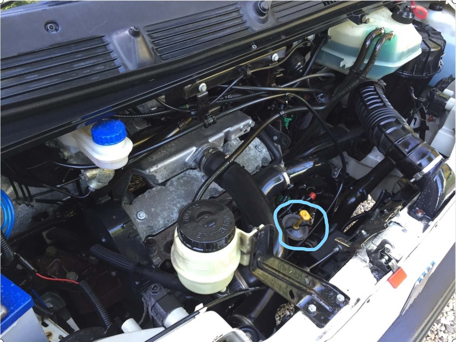

Thanks for the advice. I think i will try the semi synthetic 15W/40 and hope it will be fine. I now have a another problem as i went out today to make sure i know where everything is to do the oil change as I've never done one on something this old but for the life of me i can't find where to put the new oil in. I've looked it the manual but the diesel engine diagram looks different from the engine. The only thing i can see is the dip stick whole thing can be unscrewed to take out the dip stick and large cap, is this the right place to put in the new oil? as never seen it done that way before but like i said i can't see anywhere else to put it. I have uploaded a photo to show you what i see. Thanks again

Is there no yellow oil filler cap on the top ?
None that i can see, man this is really weird as i've never seen oil going in where the dip stick comes out. I am waiting the oil to be delivered and hopefully i can do the oil change this weekend if it turns up.
Wired what car makers do these days, I've heard of cars without a drain plug on the engine sump, but never heard of one without a filler cap.

It looks to me as though your engine is the PSA group XUD9 1905cc Turbodiesel, which was used in a range of Peugeot and Citroen cars as well as vans. The oddball Dipstick cum Oil Filler tube is a typical French concoction.

The French looking dipstick doodah is probably also the filler neck. Does the piece that the dipstick drops through unscrew in its own right?

As for the dipstick you are right it does unscrew in its own, so looks like a filler neck for the oil to go in, i've never seen anything like it before that's why i wanted to make sure it was a real thing as don't want to make a mistake by putting the oil in the wrong place and looking daft lol
