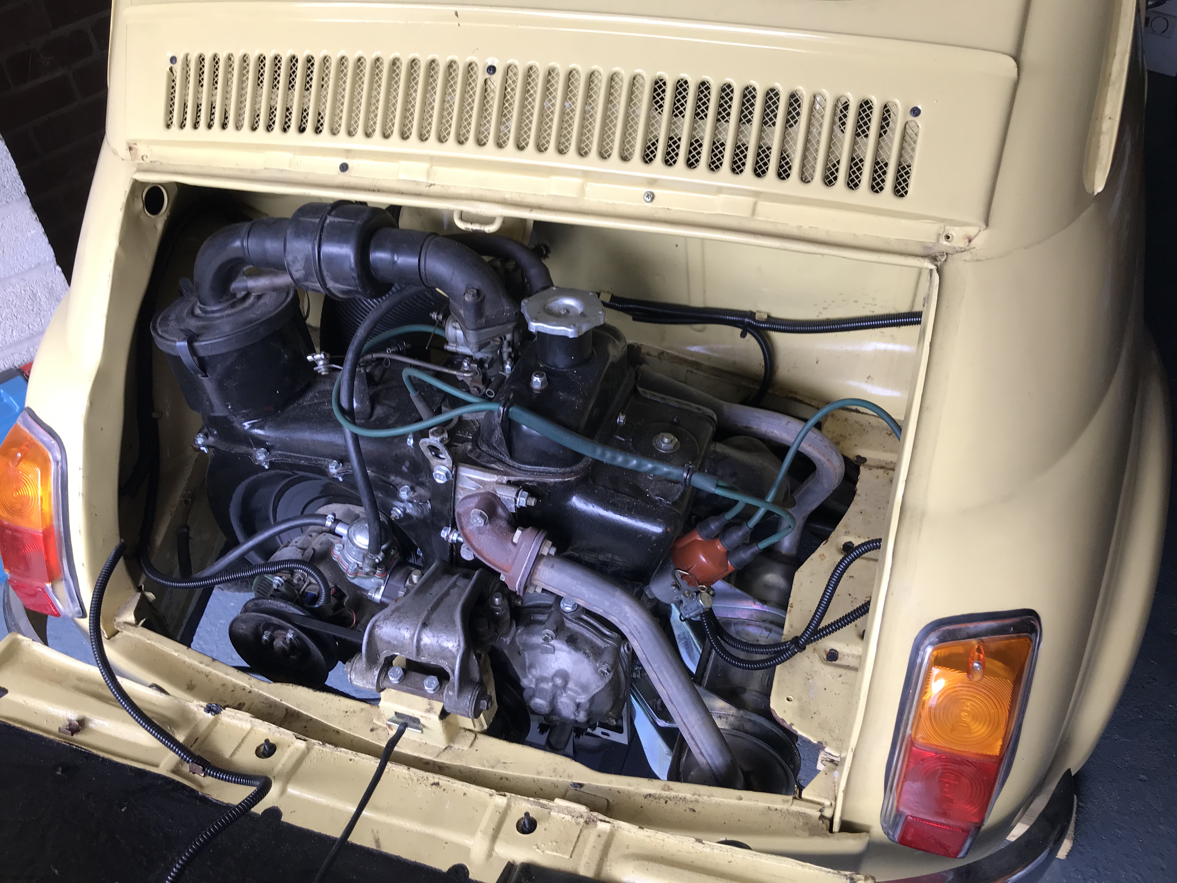

Hi all,
Thanks for the help. I’ve thought about Middle Barton but like you say, it’s quite a drive so wondered if I could find someone nearer, so any more recommendations would be appreciated.
I’ve attached some photos of the distributor, so hopefully they help you see what you need.
Thanks, Jez

You are still on points and a condenser which are prone problems from heat rising from the exhaust. There is normally a heat shield just above the exhaust but where this screws to has been butchered to fit in the exhaust. I'd have a look at changing the points, condenser, coil and spark plug leads and see how you get on. Then have a look at timing ect if that doesn't cure the issue.
It to me sounds like a fall down in spark.
If this solves it, look at moving the coil and condenser over to the other side of the engine bay where it's cooler, that's next on my list.

I can't help noticing the damage to the the HT lead in the second picture you've uploaded. I recently had a lot of trouble with my 126 which was displaying all the symptoms you list, it turned out the HT lead from the coil to the distributor had a small crack in it, and when replaced the car ran fine again. Maybe it's worth changing your leads as they aren't expensive and will rule that out as a potential cause.

I hate the way it’s been (as you put it) butchered to fit the exhaust. Does anyone have a recommendation for a heat shield that will fit around this exhaust as the one I have is clearly for a different setup, see attachment below?

Thanks for your comments. Does the Swiftune unit replace the component I’ve circled in blue in the attached photo?
If so, it only has one cable coming out (see other photos) that seems to attach to the body of the distributor and is then also connected across to the coil.
And does it need to be physically mounted to some itching specific or can I attach it near to the coil and what matters is where the two cables are attached?
And is this the correct replacement unit:
That’s a great spot! The mark that really looks like damage, is actually just some muck on the leads which I’ve cleaned off. They actually look in great condition, but I’m glad you pointed it out.
You have the standard F/L heat shield there but you have a 500R/126 type engine. If you look on the Ricambio web site they lists a 500R heat shield. You are also missing the left hand / near side engine under tray.

The factory fitted condenser fits onto the distributor with its one lead going to the points wire (the negative on the coil) and earthing out through the condenser body. With the 'Swiftune' condenser you can mount it up by the coil using one of the coil-bracket securing bolts/nuts. It comes with one lead with a 'O' connecter on it---this is the earth wire and can, again, be secured to one of the coil-bracket bolts/nuts. The other lead has a normal 'female' connector on it---this is the lead to the negative side of the coil. When you remove the condenser from the side of the distributor, put the little screw back in as this helps locate/secure the points 'deck'
