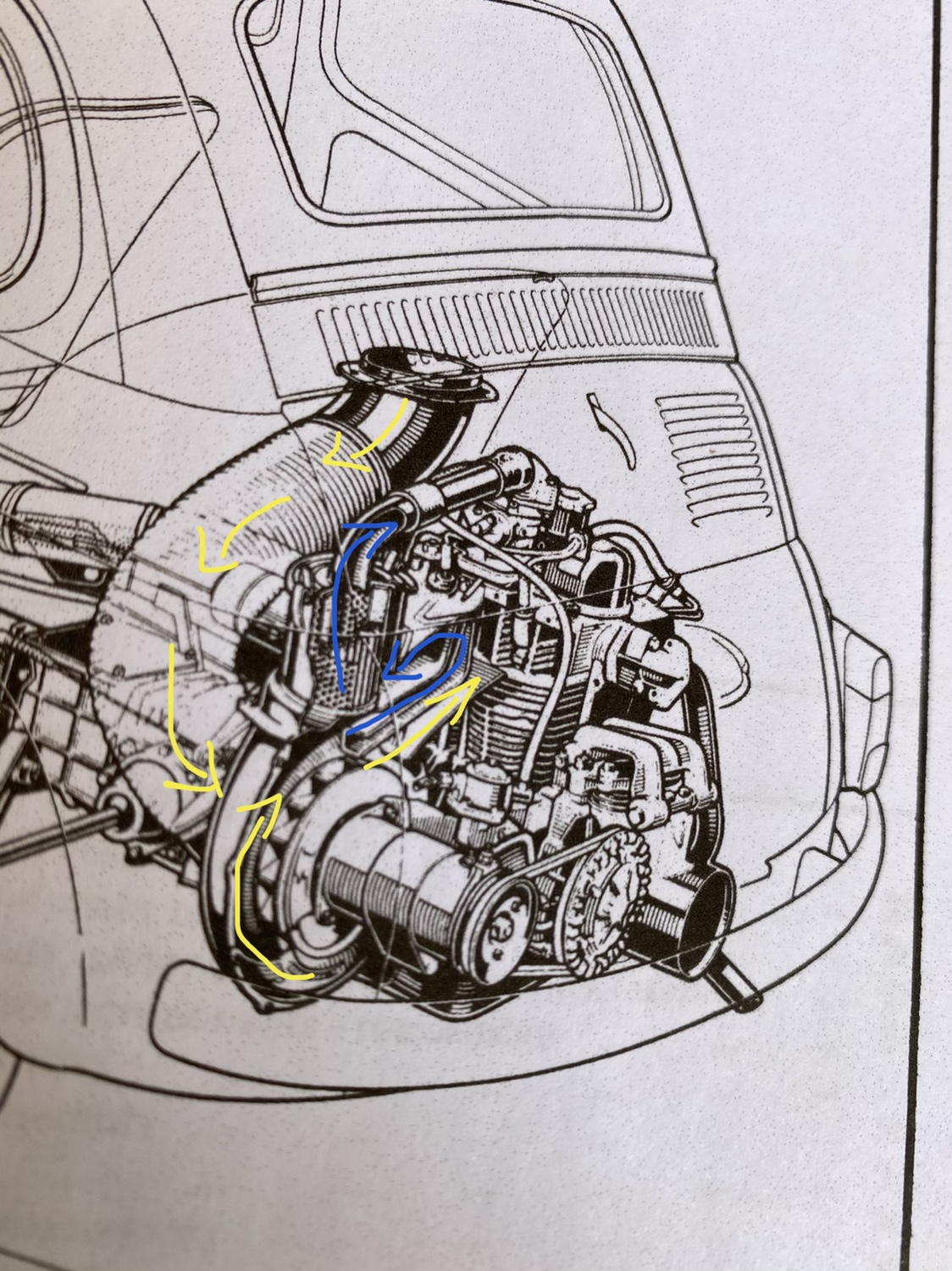

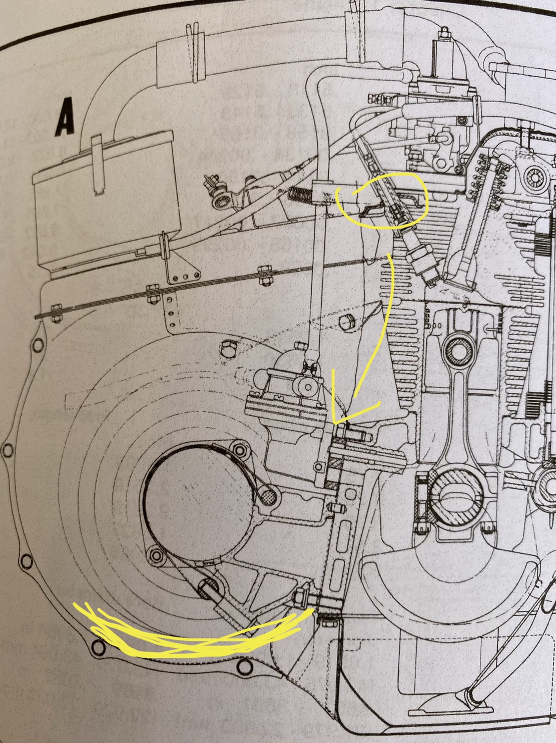

Taking your advice, considering something fell and got to the fan impeller, I'm trying to figure out how it might have gotten there.
So I don't really understand the airflow path from the fan impeller to the piston cooling fins and to the air filter.
My best guess at the moment is that there is a clear path between where the spark plugs sit to the fan impeller. There are the spark plugs rubber boots but they do not completely cover the opening.
So... question 2, is it possible that something fell through that opening and got dow to the fan?
Attached two pictures, does it make sense?

You are correct. All the black tinwork is just a shroud around the engine. Think of it as a big open box surrounding the engine. The large fan sucks air in from the large intake pipe and moves it through that shroud around the engine and then back out the opening on the right side by the distributor. Anything dropping through the spark plug openings can go straight to the impeller fan...ask me how I know.
Couple of thoughts while tinkering with mine this morning. If you are pretty confident it’s in that area I think that top cover piece can come off without moving a lot of other stuff. It’s a ton of bolts and maybe disconnect the accelerator and air intake. That would give you a pretty clear view in there and might even allow it to fling the offending bit out by just turning the engine. I wouldn’t stand to the side because it’s going to come out like a bullet.
Yes, the top cover for the fan housing can be removed as a seperate item. You need to first disconnet the throttle link to the carb. You then have the bolts+nuts round the edge, and 4 small machine screws into the cylinder head. I think that you might also have a screw at the top of the cover into the ends of the cylinder head (trying to remember at gone 11.00pm in my study)---if you would like me to double-check tommorow morning I will. With the top off you will gain better access to the fan, and might even be able to put a magnet down around the fan. If not, try starting the engine, but as Joe (Veloman) suggests, keep your head well out of the way!
