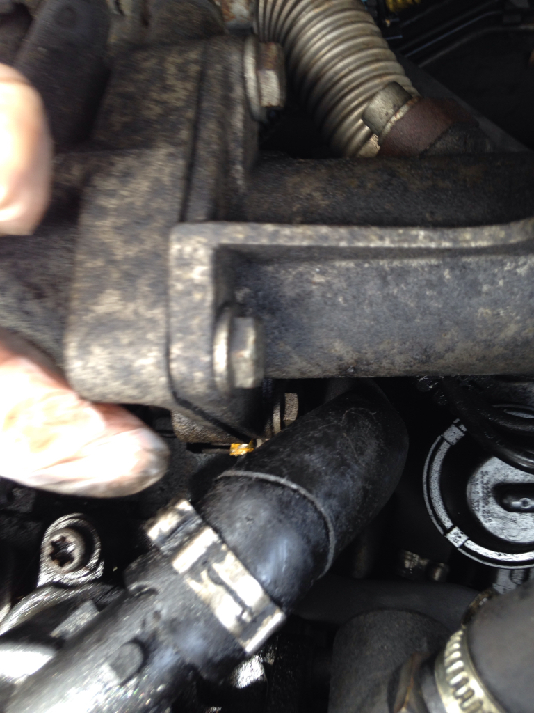

Ha! Is it allowed to be quite so simple? Lol, I've fitted a new jubilee clip but only tried it out on the road here, So far so good
