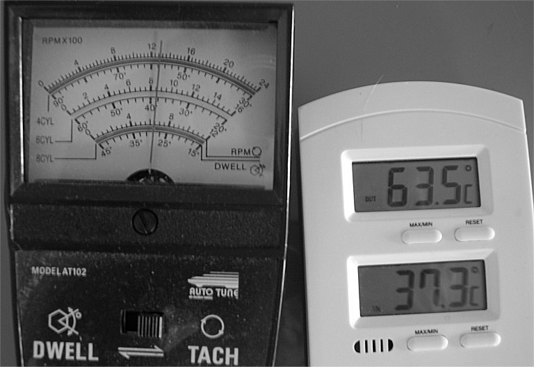

I remember doing an experiment around the time that I had my Alfa headers coated and having searched my archives, I've found the photos.
I drove the car until it was hot and placed a dual sensing digital thermometer in the engine bay on the inlet side of the engine and the roaming sensor on the firewall on the exhaust side of the engine. I set the idle to 1200rpm and closed the bonnet for 15 minutes or so then opened it and took photos. I did this both before and after the Jet-Hot coating was applied. I've attached the photos.
In this N=1 experiment, the engine bay is about 7degC cooler with the headers coated. The photos are date stamped May and June 2010 so I'm guessing that the ambient air temperature would be about 20degC (early Winter where I live).
That's all the evidence that I have - must have been feeling scientific that day ... :)
