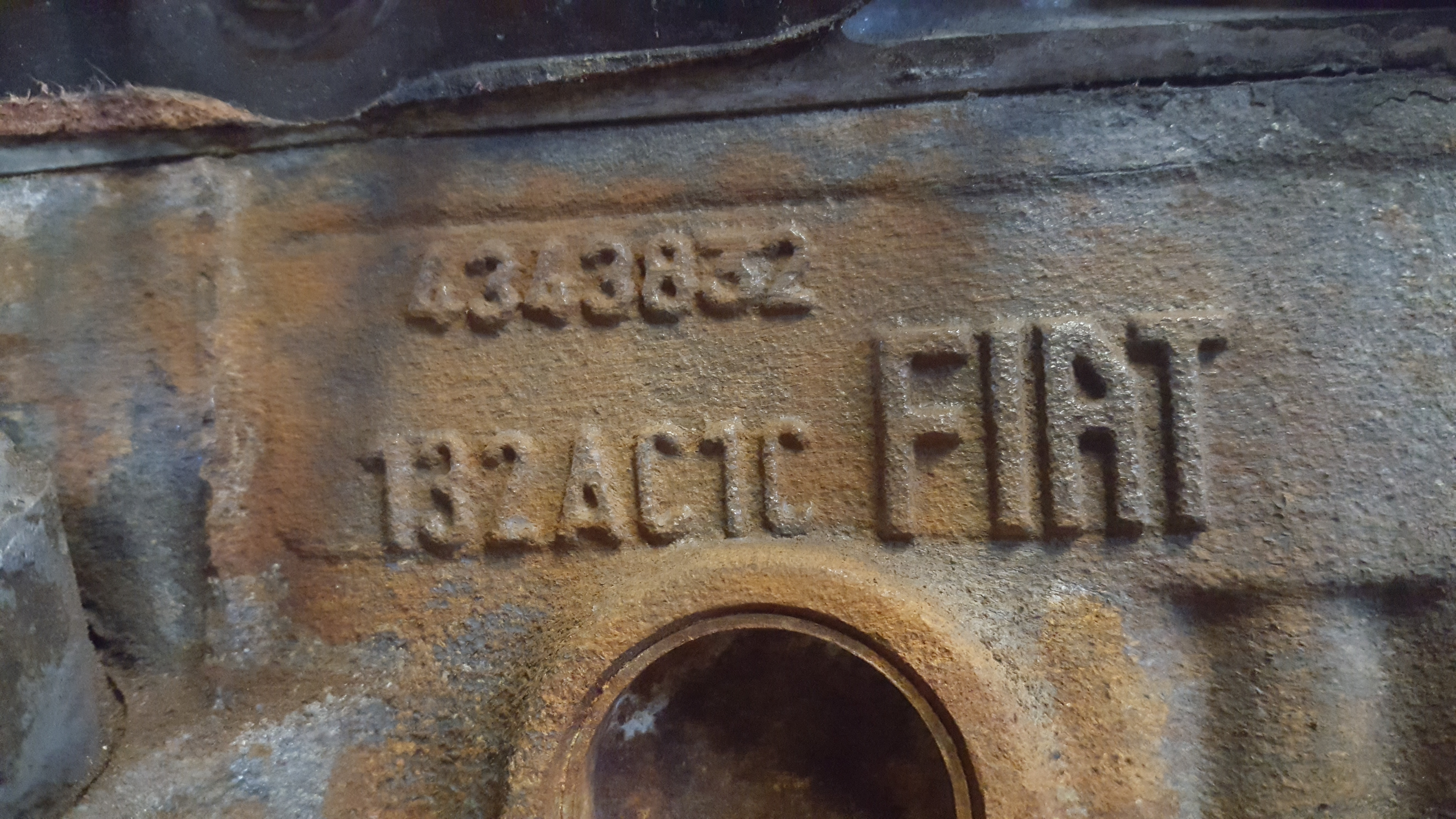

Okay New problem. I`m trying to find a new oil pump and it seems ab bit confusing. When I find the correct year ,engine size etc. the description will say " for engines after 572365". The Number on the side of my block is 4343832.
Or am I looking in the wrong place. Man this is confusing!
4343832 sounds like a casting (part) number not an engine number.
On a 1976, 1800, the engine number should be stamped on a small machined area of the cylinder block, just above the aluminum oil filter housing. (left side when viewed from the driver's seat). It should start with something like 124CC or 132AB then 'dash' then maybe 6 or 7 numbers.

The only difference I'm aware of with oil pumps is that the early pumps had a short section of splines on the driveshaft (c. 8mm) This length of splines was increased to c. 13mm. Your car being a 1976 model should have the later pump. The problem with the earlier pumps was that they had a tendency to shear off the splines inside the oil pump drive gear ( the one that is driven from the auxiliary driveshaft in the cyl. block). I'd suggest carefully checking the splines inside this drive gear and renew if in any doubt.
AL.

Here's what I`ve found..
this is another # n the block?
Yes, 0469165 that's your engine number.
The first part (132A1) is the engine type/cubic capacity. When the CC Coupe/CS Spider were introduced, they used a new variant of the Fiat twin cam engine in 1592 or 1756cc - to achieve these capacities, the bore spacing was changed from the earlier engines 1438/1608cc.(designated by engine prefixes 124AC/125BC, used in the AC/AS & BC/BS models).
The reason they used the prefix 132 was this was supposed to be the new big volume seller to replace the 124 Sedan, the 124 Coupe/Spider were smaller volume.
The intermediate numbers in your engine number (.040.5), iirc, refer to engine compression ration/power output and possibly emission equipment fitted.
So in the case of your oil pump question, I reckon you should compare 0469165 (your engine number) with the changeover engine number.
One word of caution, it's not unusual for engines to have been swapped out over the years, so always go by the number of the engine fitted, not was originally fitted or should be fitted, when ordering parts. All the engines from 1438 - 1995cc can be fitted in any of the cars, although I wouldn't recommend trying to fit the 1995cc unit into an early AS Spider, well not if you want to be able to close the hood. :)
AL.
