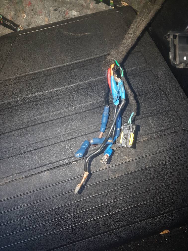

My heater is doing the usual blowing at lowest power, occasionally blowing at full power but struggling.
Anyways, I know the Eleganza doesn't have the resistor in other models but I thought to check the wiring anyway. The below images are what I found. It looks to be a pretty rubbish botch job.
My question is, are the 'repaired' wires the ones that control the blower? I've tried to remove the clips to check the wiring better but nothing seems work in pulling them apart. Any tips or advice on making it good?
Any assistance is greatly appreciated.
Turns out that there are no clips, just these four wires pushed straight in...
There are six wires total that come in and out of the blower controler:
- two that bring 12V from fuse box/ground (heavy gage)
- two that feed the blower, the one that have been repaired, originally red and black, heavy gage aswell
- two that bring the info from the climate control to the blower controler, probably thinner

On further inspection I managed to remove the motor and have a better look. Turns out that it had been removed before and was only held in by the Torx screw for the duct and a single 5.5mm bolt. The other two had snapped off and brought part of the white casing with one of the bolts.
Having gotten the motor out if the car I can see that there are 4 ports, totalling 8 wires. One at the back for the black and red plug previously pictured. A smaller black and yellow plug with blue and green wires, which according to the diagram above is the connection to the climate control.
And two further ports, one for what was originally a red and black and the other an orange and black connection.
However, my wires have been absolutely botched and the red/black and orange/black were connected directly to the pins.
All four of these are in a poor state of repair, with an original red wire looking burnt before it was hacked and spliced and one other looking charred or rusted in particular.
All of the pins on the motor look fine.
So my next step is to try and locate some plugs to refit the wiring to a better standard, or to find an auto electrician to do the job.
It's a bit confusing that M072 and M085 share the same location ! That's why you see 4 ports and a total of 8 wires.
I'd recommend to REPLACE the red and black that connect the controler to the motor (the hacked ones), using crimp lugs as for the repair.
The other 'power' wires seem ok so doesn't need replacement, maybe just replacing the lugs with new ones and re-crimp.
The two smaller blueish are just for the command, Nothing to do here.
Before reassembly, clean the terminals at the ports (wire brush / paper nails-file).
Make sure the connectors are well crimped and tight on the terminals and everything sould be fine ...
BRs, Bernie

So I got to work getting rid of the old bodge job.
And stripping back some clean wiring.
And made four tidy connections.
All fits nice and snuggly.

I decided to re-do the butt connectors with a larger size as I wasn't entirely happy. In doing so I also decided to remove the motor from the car again and see if I can re-seat it correctly.
Whilst it was out I noticed that it had been catching on ths white plastic housing so that was lucky! Also whilst I had it out I hooked it up to the improved wiring and turned it on.
Spinning like brand new! Now just to get it back in and sit it right. I managed to get a longer screw into the rear hole and secure it nice and snugly.
Wires tucked away neatly
