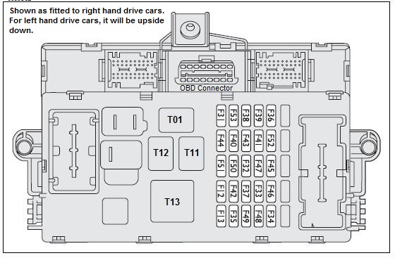

What might be cause of this? Don't want to believe that window controls might have made so much problem :( Have an idea to connect my laptop to check or errors, but can't find OBD anywhere (not like I could find it in less than 3 minutes of looking while sitting in front of wheel, i suppose). Really want to love Stilo as my old Brava body is on death line and Multipla already whole year just standing with demons inside it's engine...

Have you found the OBD2 socket? Above the fuses. Under the dashboard.

No, I might be dumb or something, but can't see OBD2 socket. Found fuses tho would be nice if I could get some graph which fuse is where :confused: whole fuse box on top of engine have no top cap, neither have one under steering wheel and I think I need to check some fuses because I have some malfunctions going on (windshield wipers possessed, lights don't move when trying to raise/lower them, car doesn't recognize if I open driver door).

The OBD connector is the 16 pin connector in the dashboard fuse box. For right hand drive cars, it's at the top of the fuse box, as in the diagram below. For left hand drive cars, the fuse box is mounted to opposite way up, so the OBD connector will be at the bottom of the fuse box.
Diagrams for the engine and rear compartment fuse boxes are also below. Fuse numbers and their designations are shown in the Stilo handbook. If you don't already have one, you can download one from the forum downloads section here: https://www.fiatforum.com/downloads.php?do=download&downloadid=2

Wow, I feel ashamed it took me this much effort to find OBD... will try to check what I can see on my laptop and try to find causes of at least few problems. Not like I expect much :D
