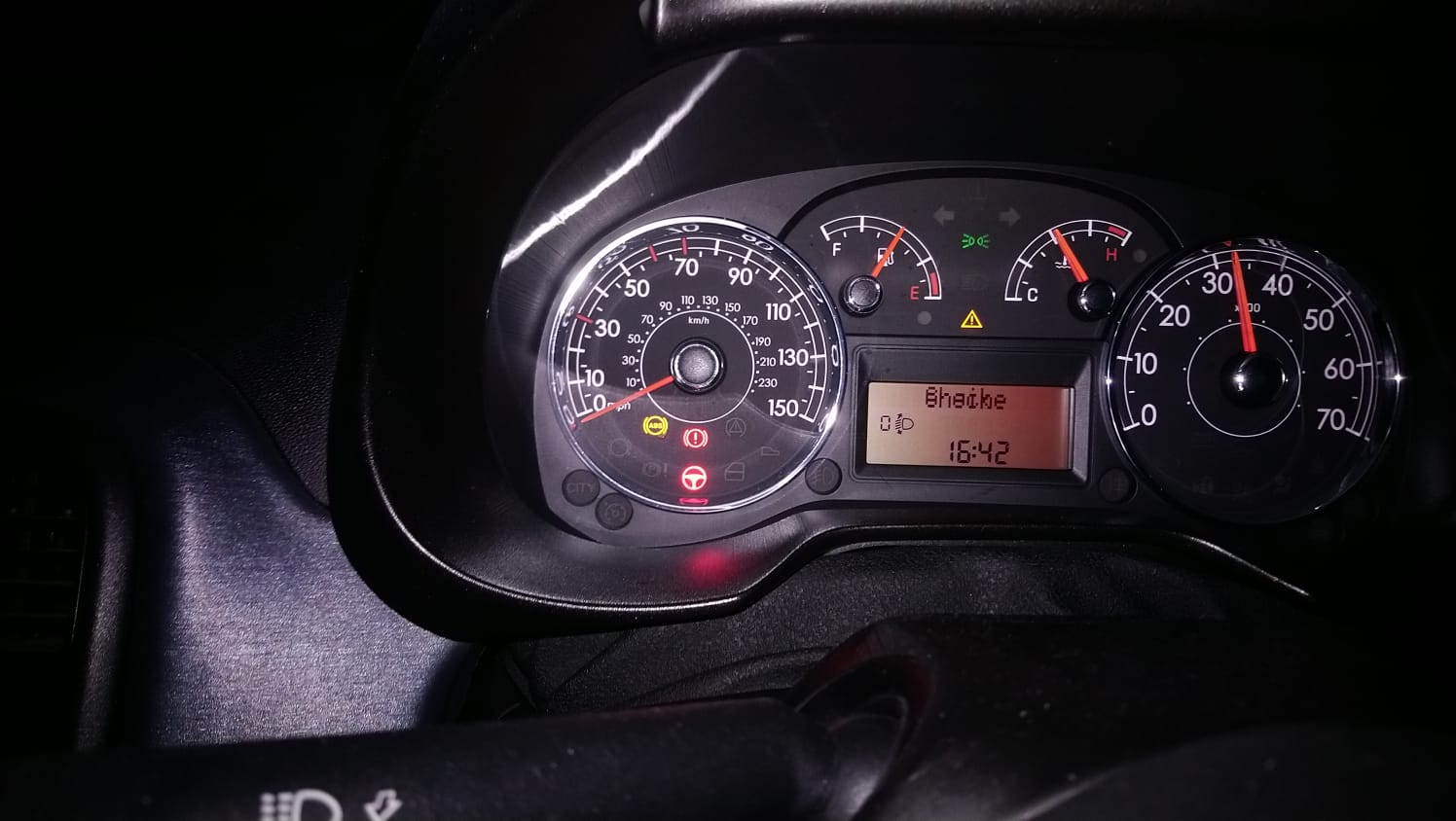

I am having trouble with my 2009 Fiat Grande Punto 1.4 Petrol
The car has 75000 miles if relevant.

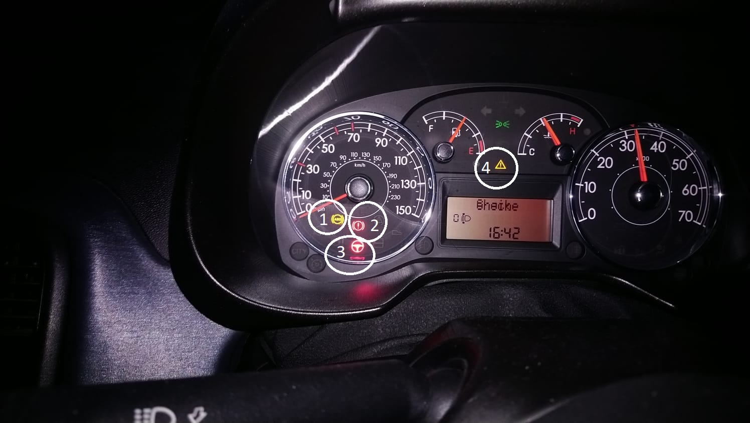

I attached 2 pics with the dash lights that show in the following sequence:
Usually: 1 & 2 will appear first, then 3. Sometimes 4 will light from the start but most times will light at very end.
So after 1, 2 & 3 will light the speedometer will stop working. After a few seconds only light no. 3 will remain and the speedometer will start working again.
At this point, the power steering fails and the fuel cut off light (no.4) will stay on.
What I did so far:
- changed the battery, brand new one
- cleaned the earth leads ( from ( - ) to chassis and on gearbox
- new earth lead from ECU to battery.
Now the car does the same but not so often. I really don't know what to do anymore.
I checked the wires in the booth, they seem to be ok, at least what I could see.
Today the car engine stopped and when I tried to restart it the key wasn't recognized so I had to disconnect the battery and wait for 10 mins. After this worked but the engine stopped again. The second time it started.
Any advice mates?

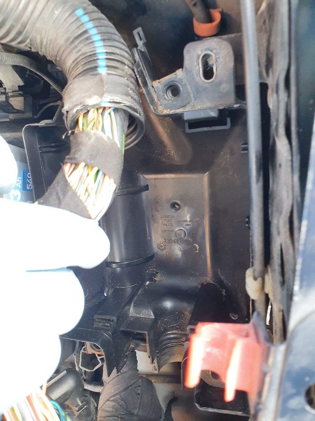

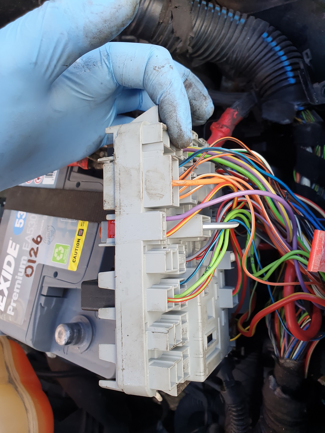

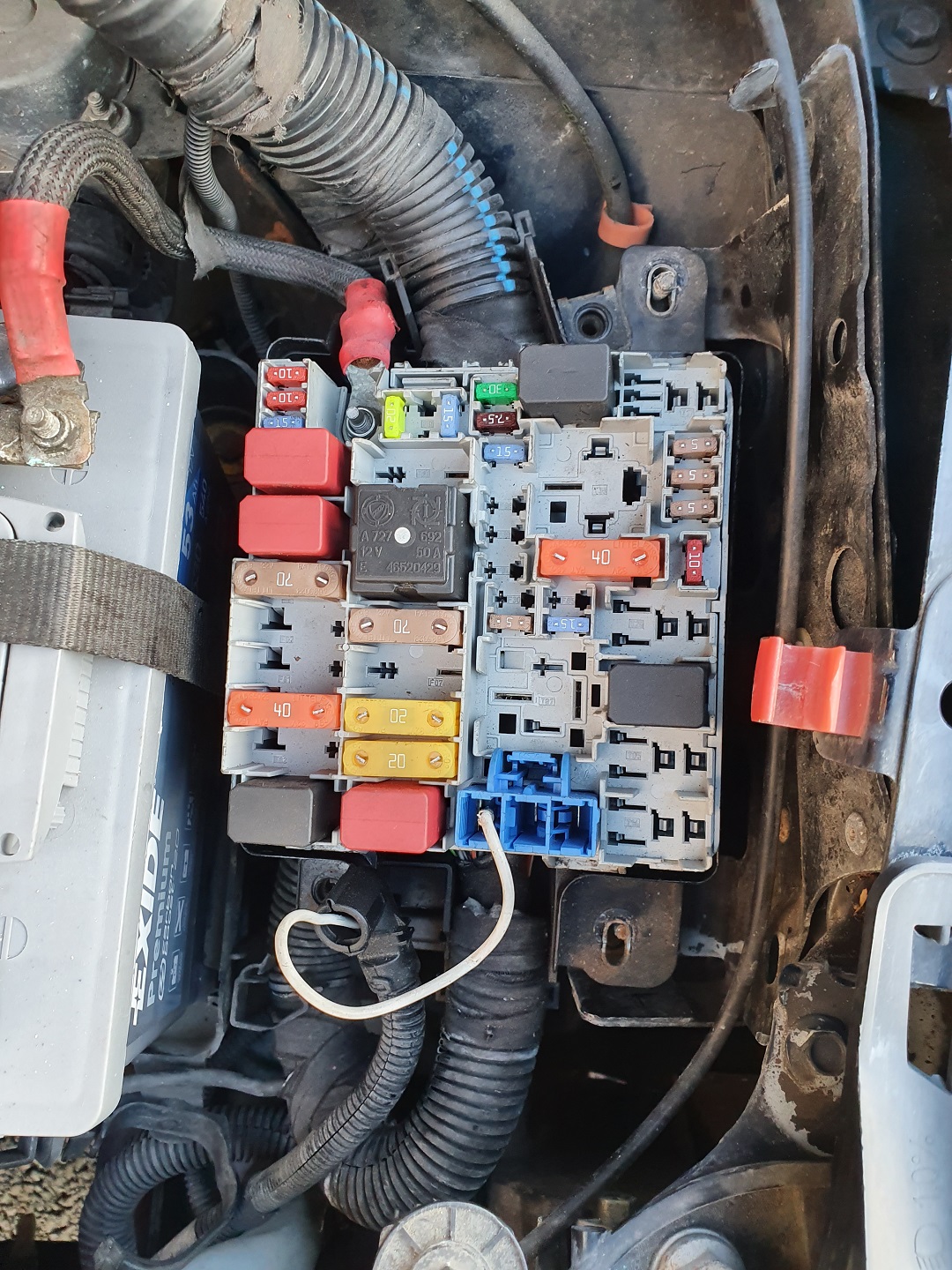

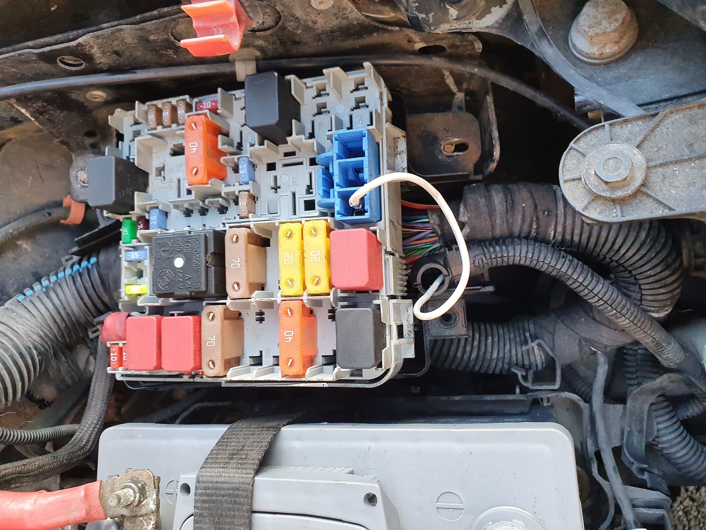

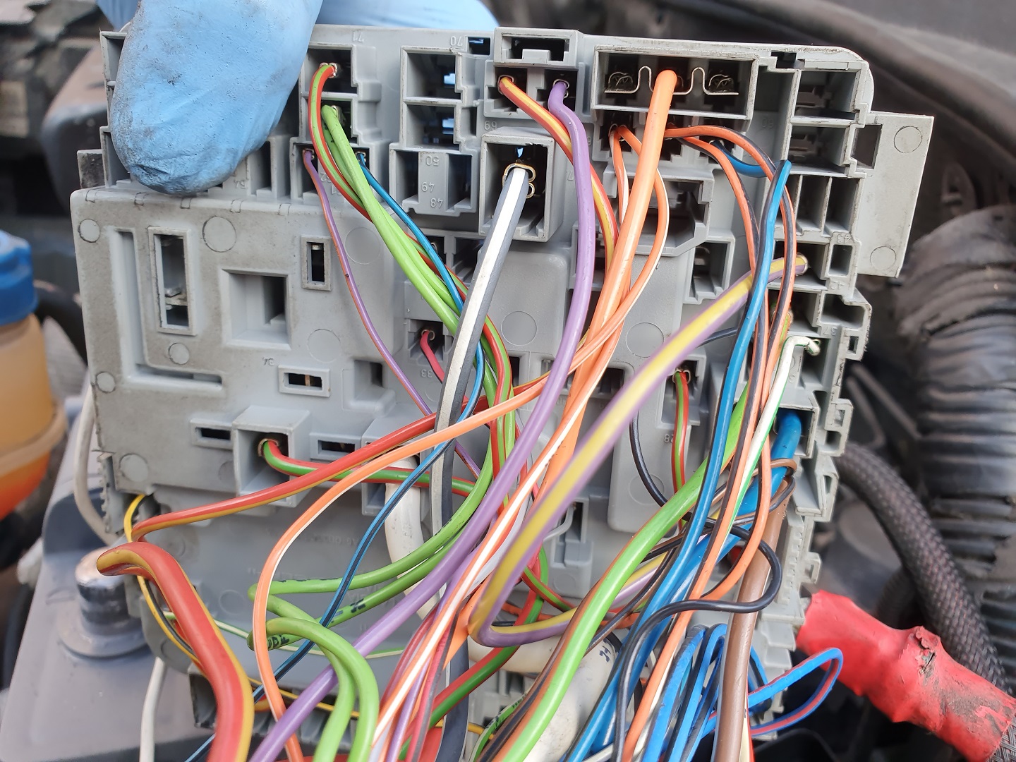

I just disassembled the fusebox in the engine bay and there was no trace of water. The cables are intact and seem ok. The sockets are clean, however the fuses are flimsy and wobbly (n). The relays are solid as glued in :D
I've attached some pictures, tell me your opinion, maybe I missed something.

Looks like you have done a thorough job of taking it apart and inspecting everything to me. When you say the fuses are 'loose' and 'woobly' are they not secure ?...Do you think this could be a problem?
In my opinion it shouldn't affect because the fuse are secure in the sockets but the sockets are just clamped at the end of the cable.
When I firstly start the car, in the morning and I go to work, runs perfect. At 5 pm when I start it again after 8 hours, it rus perfect. If I decide to go somewhere else let say in 20 min from when I got home, the dashboard goes nuts (as in pictures from my first post).
I find this very strange. It's a random problem, and because it's random, it's very hard to detect the cause.
