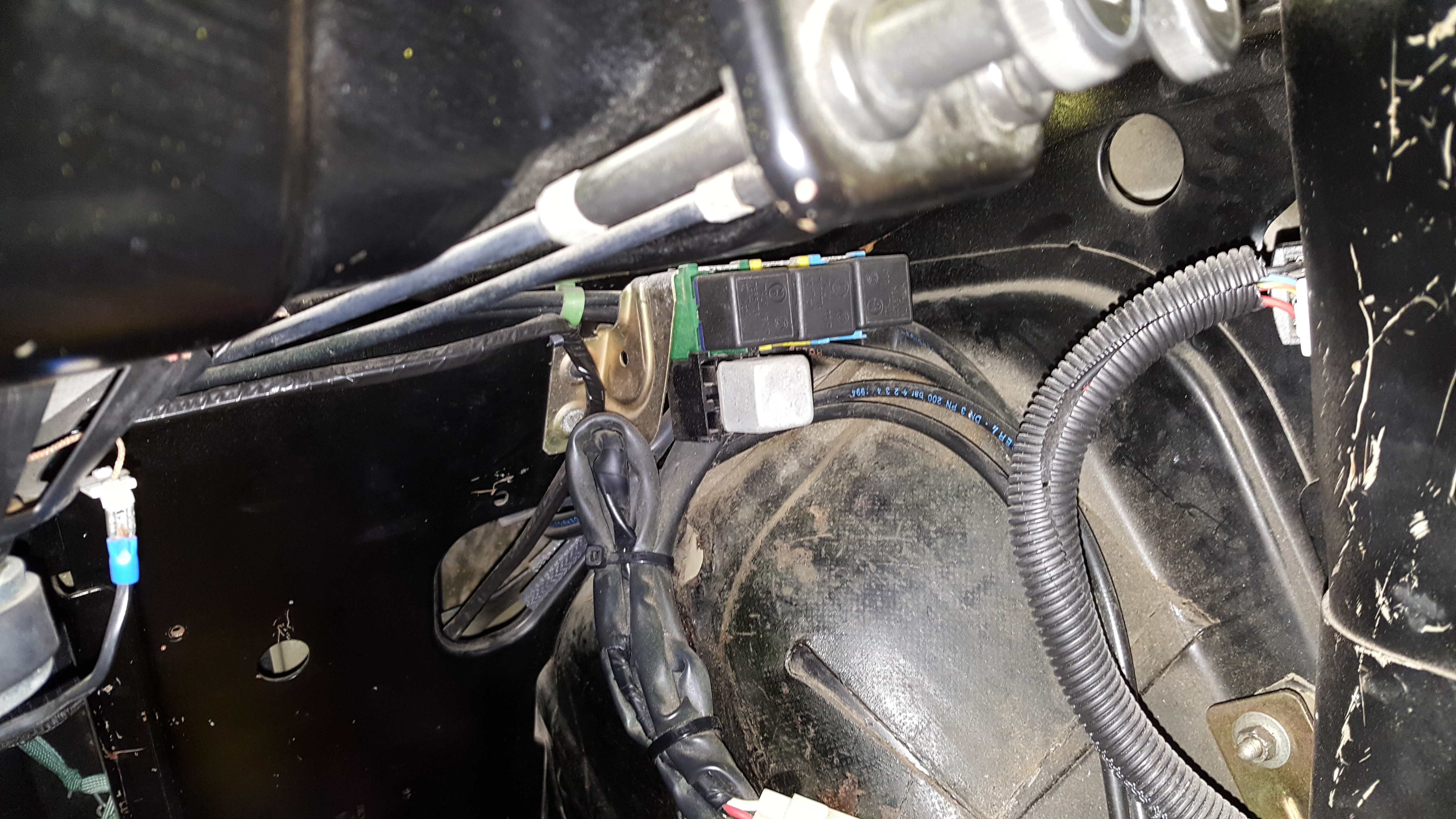

You should have 4 relays in the boot near the pump,
check the left one.
Check the bottom one on the left or any of them

Having just read this thread it relates to my current problem. On my Punto there are only three relays in the boot, rather than four. This must be right as the roof worked before it went into storage. How much fluid is"enough"?

The only manual that cover the roof is the official one from fiat. you can buy a copy on DVD from ebay. If I remember correct there was a modification to the roof electrics and this may be why you only have 3 relays.

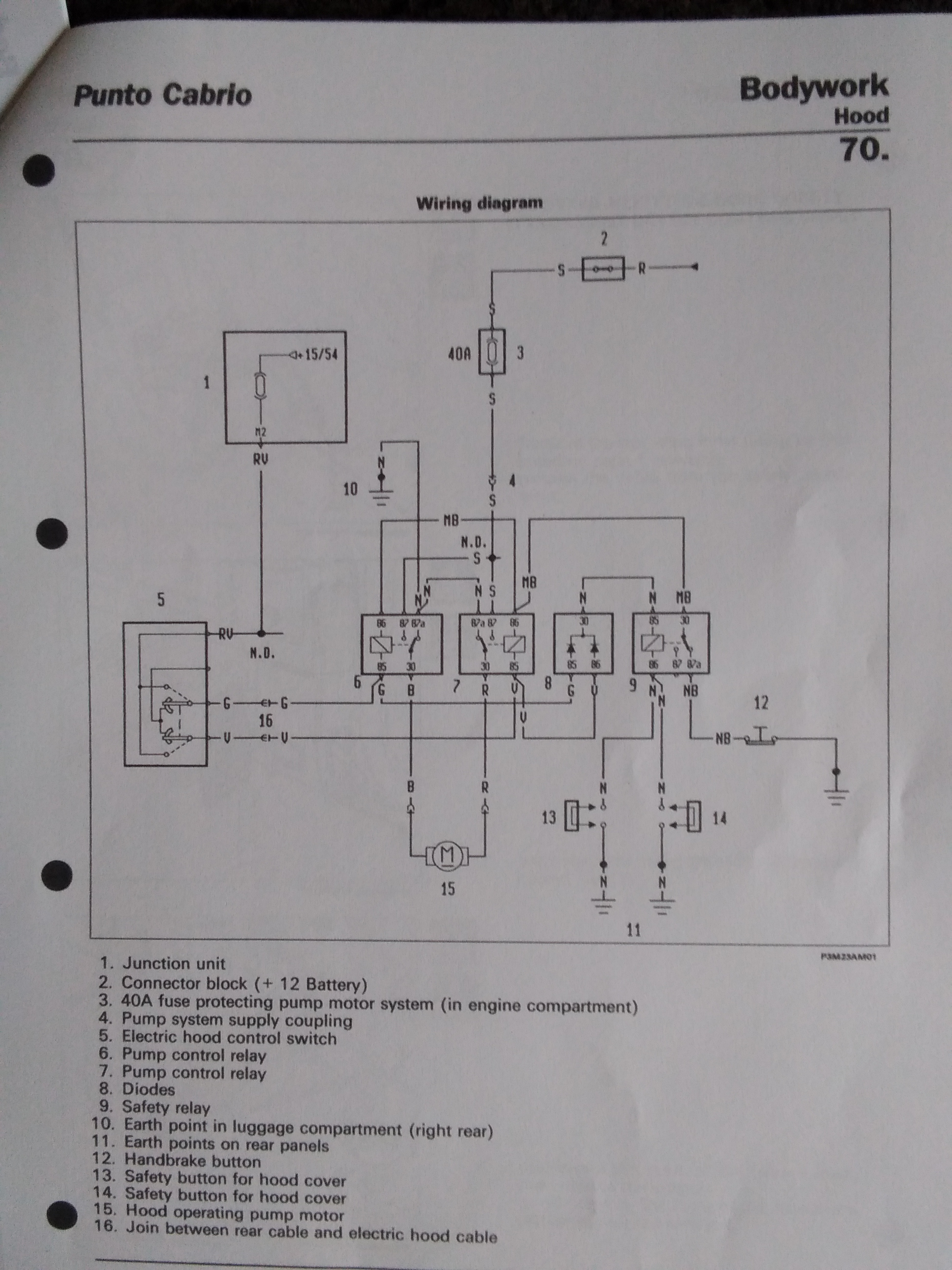

Having now got the Fiat manual for the Punto, I can answer my own questions and, maybe help others along the way.
The reason for my low hydraulic fluid level is because the hood is up and the pipes are filled with fluid.
Apparently, the marks on the container are Min and Max levels. Minimum with the hood up and Maximum with the hood folded down.
The wiring for the hood mechanism changed sometime after 1996. Earlier ones had a feed from the ignition switch, whilst later ones didn't. The wiring diagram is for the later ones.
I haven't sussed out the location of the safety buttons just yet.

I may have confused you a little. From memory there is only 1 switch but two sets of wires. one for the light on the dash an the other to the roof circuit.
The "safety buttons" are the little bits that the roof cover attach to. It stops you raising the hood with the cover in place.
