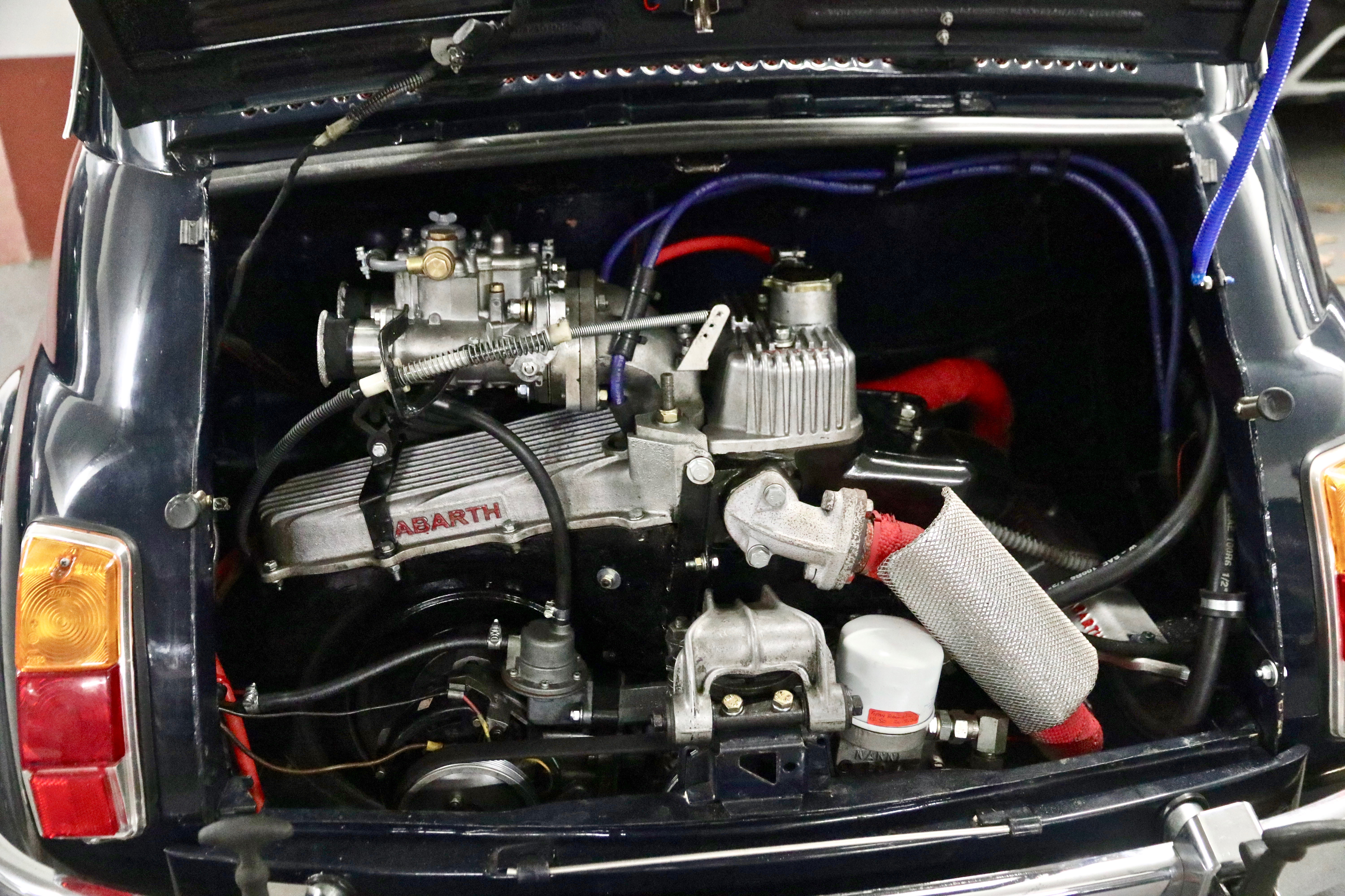

My 652 Fiat 500 has been serviced & overhauled by a very reputable Abarth specialist MB Garage & runs much better for it apart from one thing, Starting is a nightmare due to the fact MB garage disconnected the electric pump & re fitted the original mechanical pump. The problem I have is when the car has been standing for a few days the mechanical pump has to fill the Weber DCO 40 with fuel obviously before it will start, this can take over 30 to 45 seconds putting a strain on the battery & starter. When the electric pump was connected as soon as the ignition is on the fuel fills the carb & fires up.

My
question is - Is it possible to fit a T piece into the fuel inlet near the carb, then connect the electric pump activated by a relay switch on the dash, when starting from cold, As soon as the carb is filled I could switch it off so the mechanical pump will take over, would I be forcing to much fuel into the carb?
I know the weber 40 is too big for the engine, but it runs great when its warm with no problem,
Looking forward to your valuable advise as usual Barry

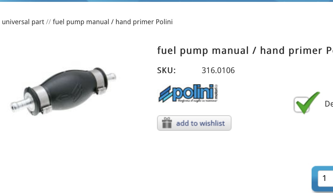

Hi Tom I can see the logic in pressurising the fuel tank, I have also been looking at the Piston head forum where a quite a few people with Weber carbs have encountered the same problem of fuel evaporation, one or two have said use a hand fuel pump primer. If this was fitted between the mechanical pump near the carb would you think i would be able to fill the carb with it enough? my only concern with it is - the safety of a rubber primer bulb, which is a similar scenario as fitting a plastic see through filter(would the rubber bulb perish )

There should always be fuel available at the inlet for the mechanical pump. There was even a warning sticker, fitted by FIAT to that effect. Once started, fuel is delivered partly by gravity. So there should be no need to pressurise the tank in order to deliver fuel to the pump. It seems likely that the disc-valves inside the pump would be an obstacle to any separate priming-pump.

Many thanks for your reply, Yes I partially agree with you, however 1st of all I know the carb is not the most ideal however as it came with the car & I have just spent quite a lot on having it set up & fully stripped & re built plus it runs great when its warm, it also starts fine after 24 to 36 hours or so but if I leave it for longer say a week the petrol seems to either drain off or evaporate this appears to be a common problem with Weber 40 carbs. (don’t think it actually evaporates as its only 8 degrees in my garage, it seems to drain off), if I fit an electric pump it fills the carb before the engine turns over then starts. As the mechanical pump has now been serviced and runs ok when warm I have been advised to keep it on. Hence the idea of just fitting a hand primer may resolve the problem.
