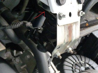

The rubber tube runs from the vacuum control valve in front of you as you open the bonnet.
arrowed is one of the two pipes at the valve, one is the vacuum in and the other goes to the EGR, plus there is a power cable for the valve.

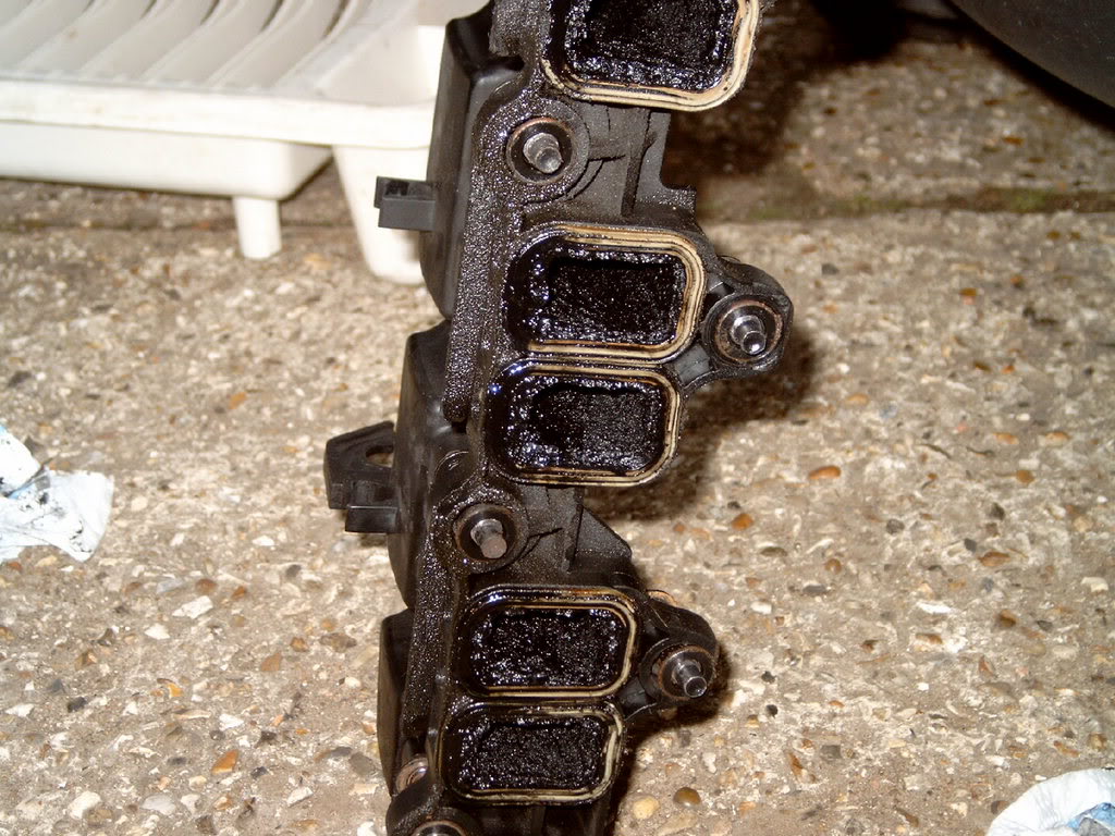

This is a picture of a very clogged inlet manifold.
I have egr opening reduced on one car and blocked in another but to be fair when its that oily its probably the pcv putting oil in the intake that traps the soot. Also bear in mind that egr reduces egt so blocking it on a hot running engine can lead to head damage, blowing manifolds etc. It not a one size fits all solution.
