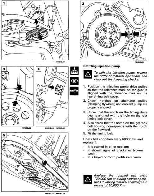

the pulley mark needs to line up with the belt cover mark. there are marks for everything on the car, so you dont use the marks on the belt.
see the attached sheet from the fiat workshop manual.

This is the diagram on the box which the new cambelt came in. (Notice how I hadn't thrown this empty cartion out, just the unimportant pump!)
All three markings had been aligned and the markings on the belt fitted too. I suppose the belt-markings are just there to make sure it is fitted correctly and that the correct amount of teeth is between each stage.
