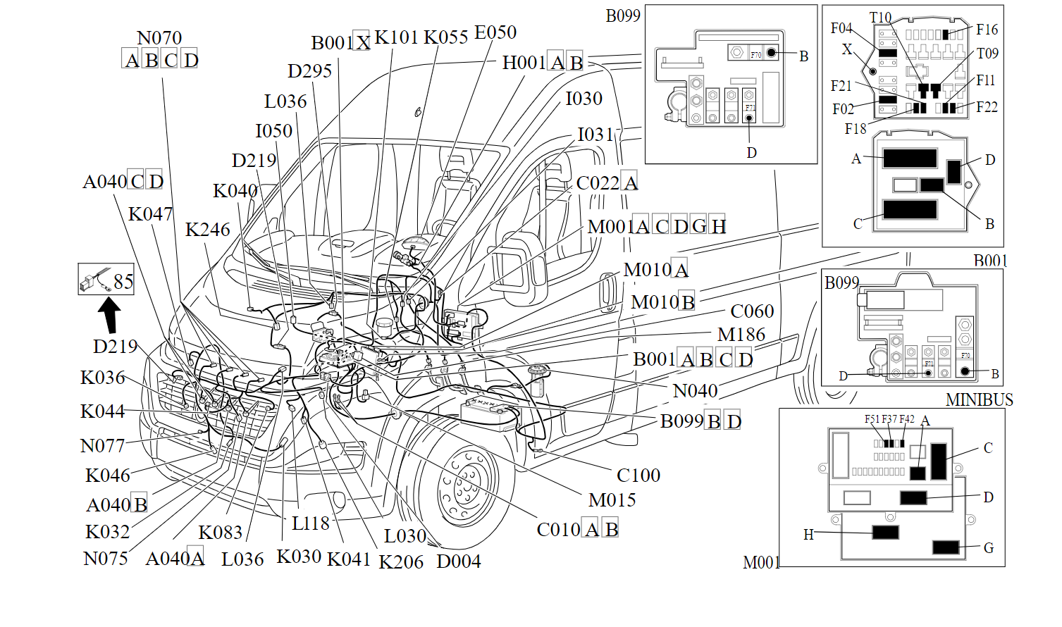

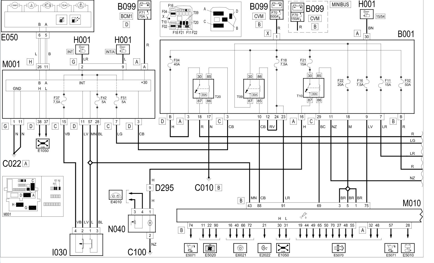

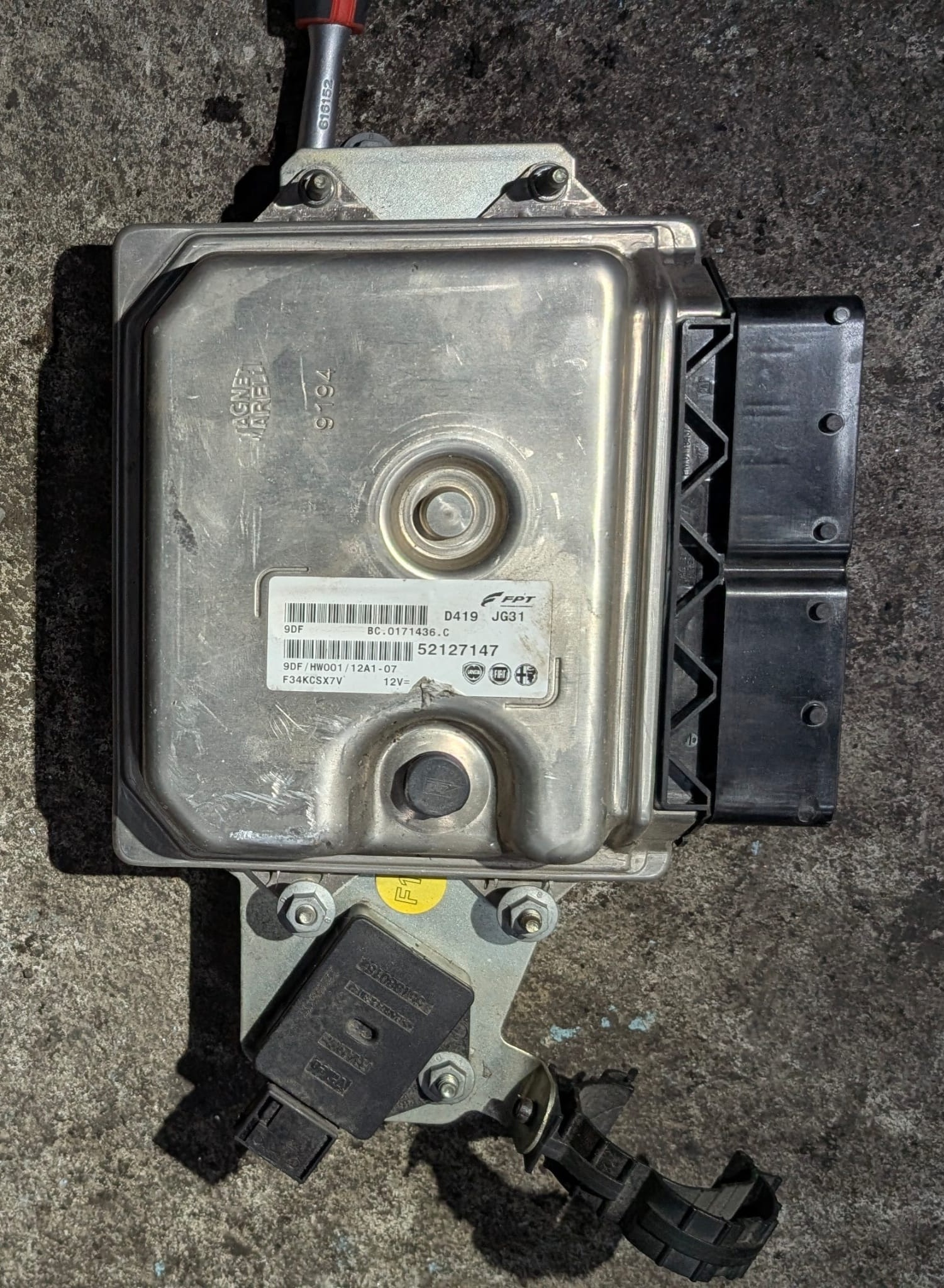

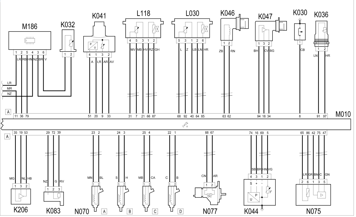

Hi, can anyone help me with the diagram pinout for ECU 9DF HW001 52127147 2019-2020 ?
Thank you very much @theoneandonly!
Can you help me also with the diagram for 2019 single EGR version?
