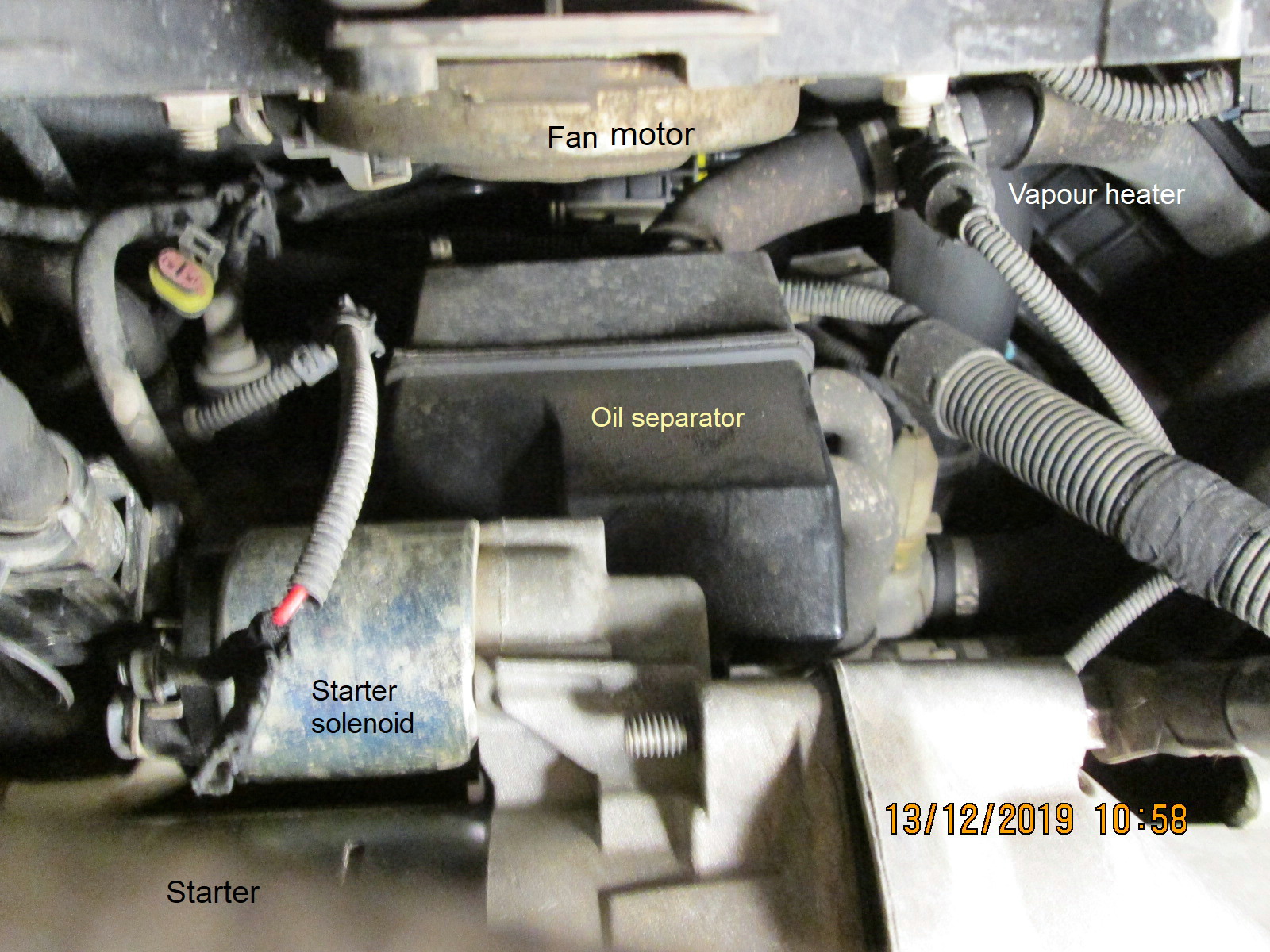

I did not originally reply as it seemed that you already sufficient help. However are you sure of your diagnosis? A common cause of speedometer failure on x244 and perhaps later models, is failure of fuse F11 in the engine bay fusebox. Fuse F11 is notorious, as it supplies several items including the "Oil Vapour Heater". This heater can develope a short circuit fault that will repeatedly blow F11.
In the UK climate, the simple fix is to unplug the heater. Attached photo is from underneath a vehicle with a 2.8jtd engine.
