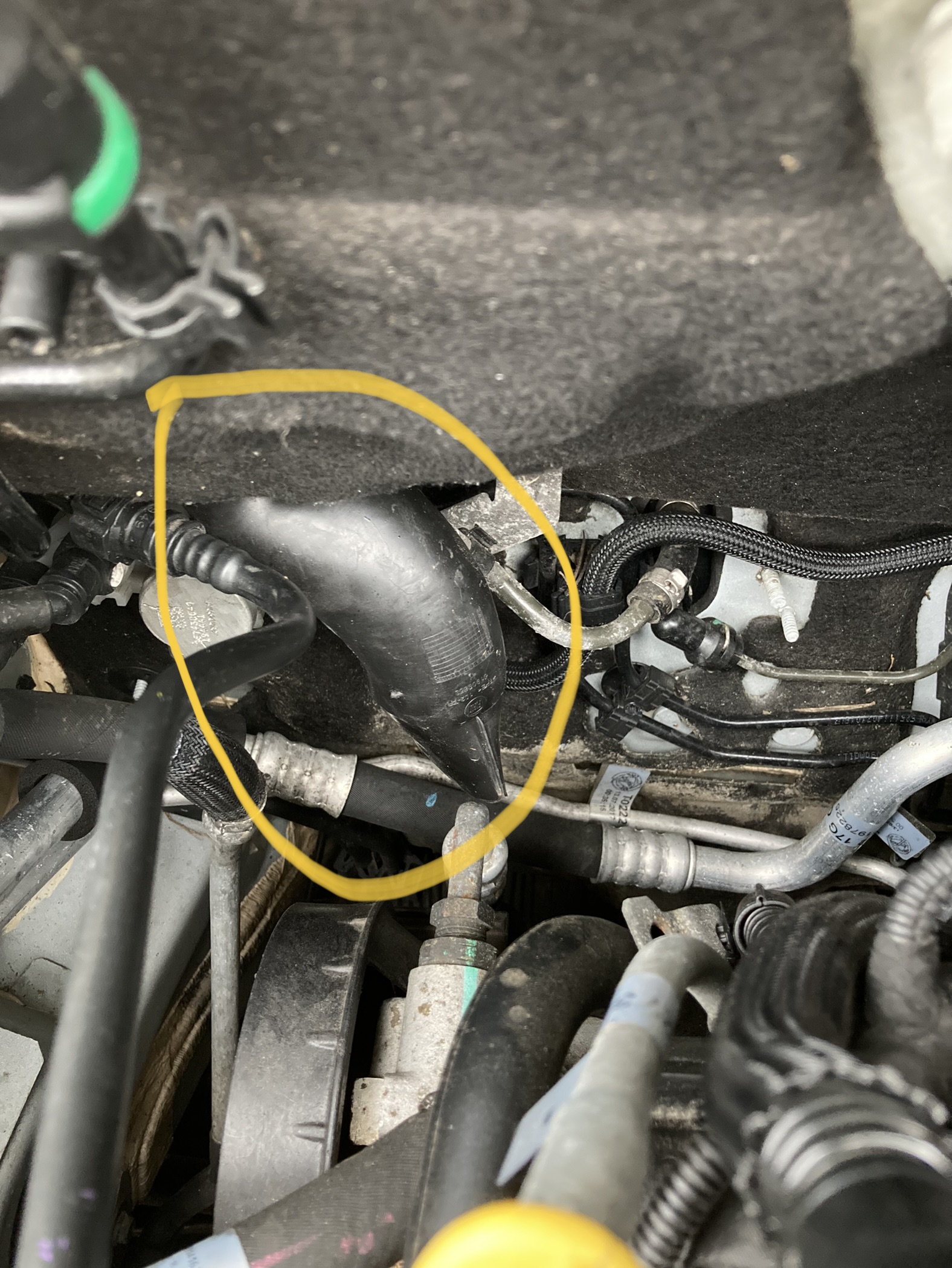

Hi guys, Is the driver’s side duck billl drain on my 2015 doblo in the correct position , i bought a new replacement as one was missing but I’m not sure if it’s right. Thanks Steve
Hi guys, Is the driver’s side duck billl drain on my 2015 doblo in the correct position , i bought a new replacement as one was missing but I’m not sure if it’s right. Thanks Steve View attachment 417764

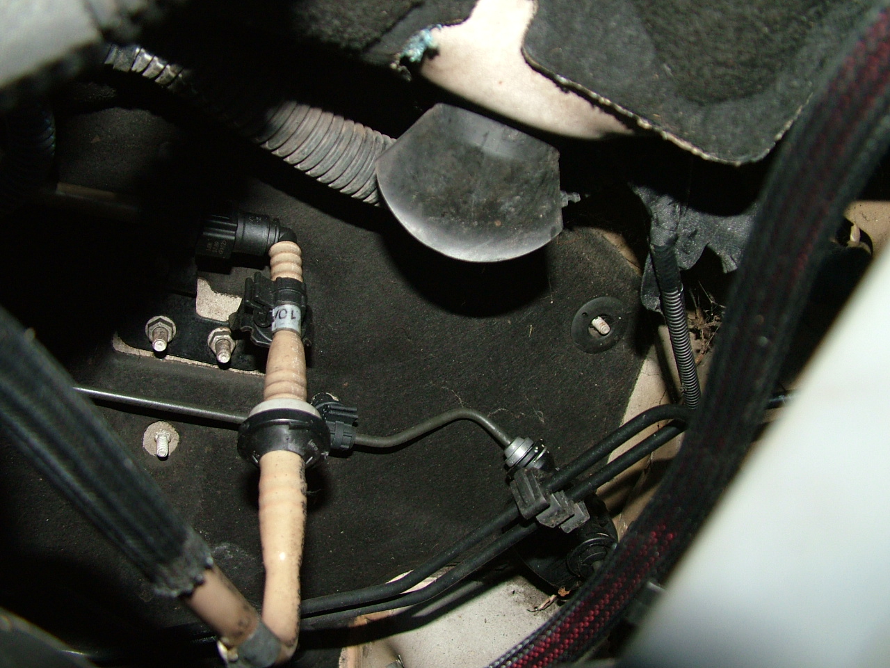

I had a look at my 2010 Doblo Maxi 1.6 multijet to see if similar, but on mine the duck bill one goes to the N/S .

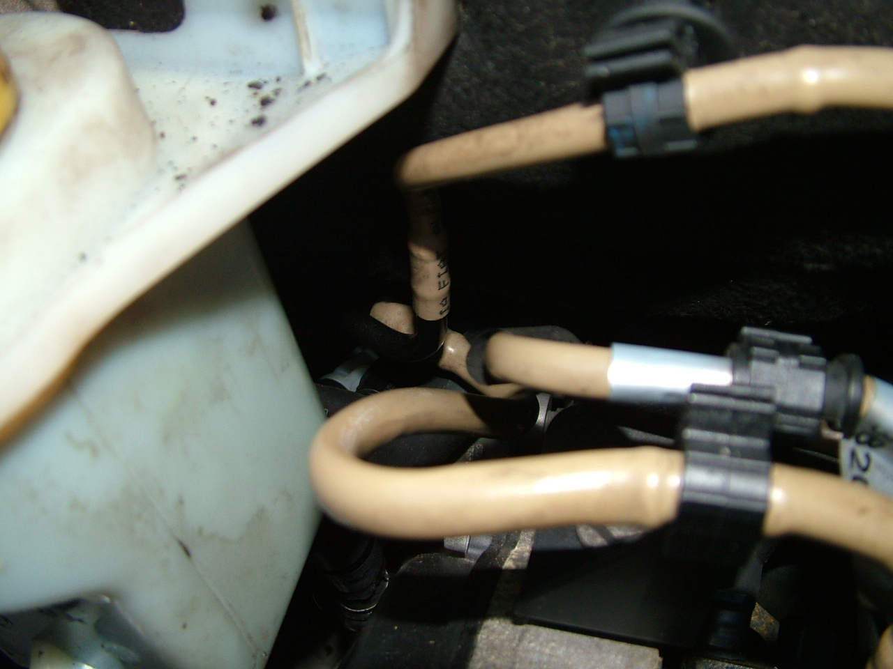

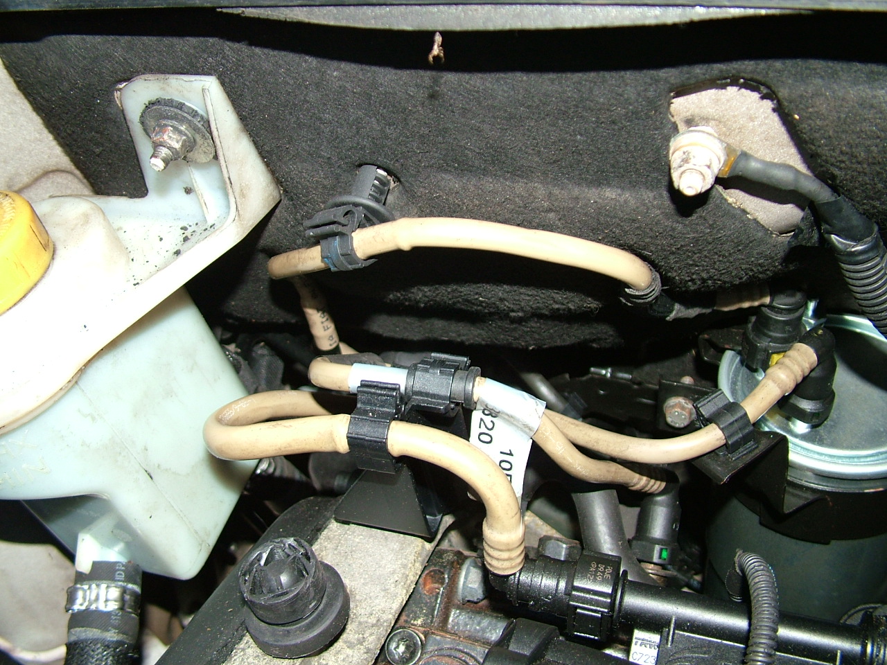

On mine the O/S one starts from the drain in the heater box area and goes towards the O/S inner wing under tha brake fluid resorvoir as more of a pipe than a duck bill. The first pic is the N/S duck bill which is a larger diameter than the O/S.
Sorry for the poor pics.

Thanks for taking time to look mike 👍🏻I think I’ve got the wrong part as it looks same as the passenger side 🙄, I’ve tried turning towards the brake fluid resovoir but there’s not enough room either with the air con pipes , I twill see if I can find one in the scrappy to have a look at .

Yeah I’m getting squeal when it rains, I’ll have a look at it 👍🏻
I can't say for certain but I think it goes from the heater box area , under the brake fluid resorvoir and then into a hole in the inner wing , so the water would drain out in the wheel arch and not in the engine compartment at all. It also to me looks a smaller diameter pipe than the large duck bill thing on the N/S which presumably leaks out on to the back of the gearbox area.
So going by that if you look through the o/s wheel arch towards the engine compartment you may see a hole that it fits into.
Assuming my 2010 is similar to your newer model;)
