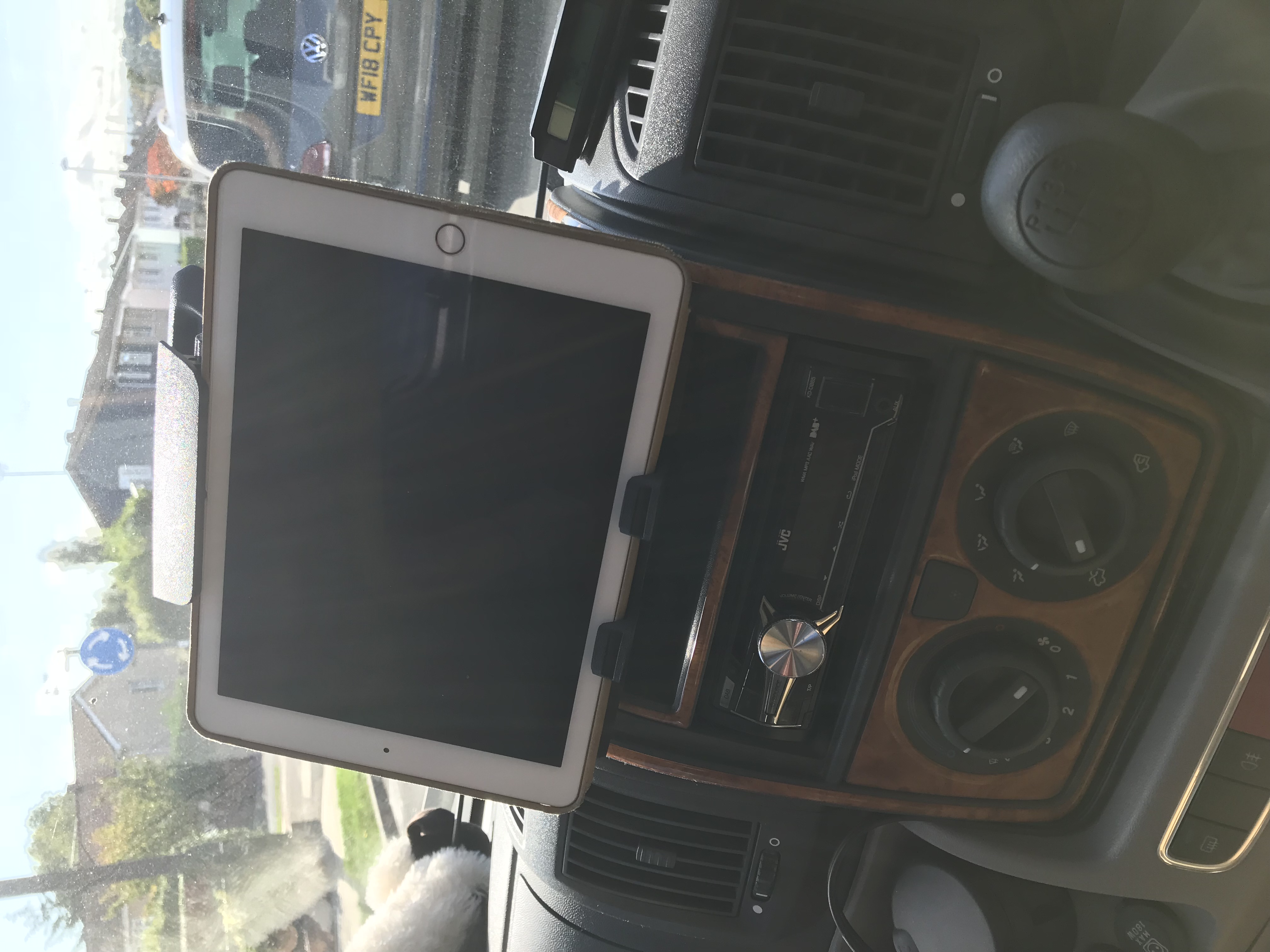

I have fitted one to my 2011 x250 although it does have a passenger airbag, now I can have my iPad fitted and running Copilot satnav. I got mine on ebayalthough it is listed as 2014 X290 only. It is a direct fit no worries.
