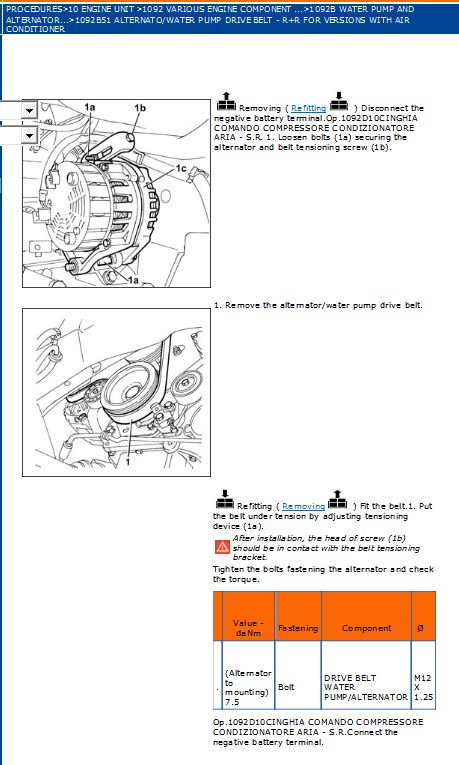

the eLearn I have is largely silent about the tensions for these belts.
Such info as there is is attached:
Thanks Hugh.
Yes that is indeed the lower of the two drive belts on my Ducato.
But as you say, buggerall information about how much tension to put on the belt using the adjuster!
I assume the same total lack of information about belt tensioning applies to the "Elearn" manual description of how to change the upper drive belt as well.
